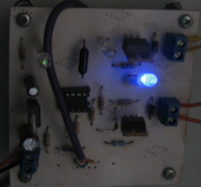

The PICAXE08M controller is working nice but I think is something wrong with my battery. Is discharging fast (in minutes) from 14.4V to 13V having only the controller as consumer. Then, discharging is slowed. With controller on, it will not reach 11V (a limit when consumer is disconnected) all night and morning, when charging is started. Not connected yet a consumer, I have a cold because of the spring wind . But I can see from my bed when LED's go on/off.
Today not reached a complete charging because of clouds. I'm curious to see how is working with the windmill...Edited by vasi 2009-03-11

The current is around 133.5 mA with two LED's (double intensity) and one relay on (maybe I must change the battery on my multimeter ...).

The relay would be the culprit. I design with double throw relays, so I can select NO or NC contacts, to avoid having relays powered unless power consumed would go to a diversion or is excess to battery needs.

My green LED died (double intensity - you can see, it still emits light)! Is connected at 5V with a 1K resistor.
I lost also 10 white LED's double intensity, used on a LED lamp as here, the same behaviour as green LED.
No data about those LED's ...
