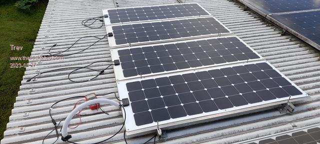

There are 4 panels in series to make 48v nominal for charging the quad bike battery, nominal 48v. First installed 9 April 2021.

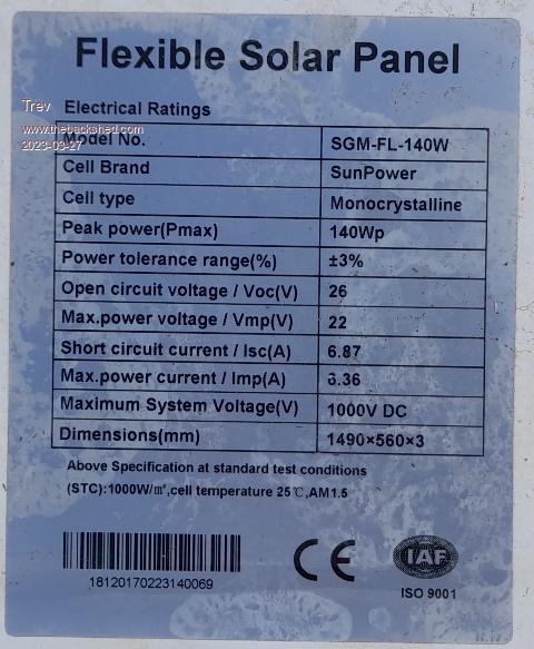

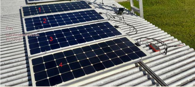

If I take a picture like this and number the panels. (This picture is taken today, 27 March 2023, before I removed the 2 failed panels)
Then it was number 3 panel that failed in just over 1 year. Replaced 1 May 2022.
Number 2 panel failed in approximately 1 year and 7 months. Failed late October 2022. Replaced in December 2022.

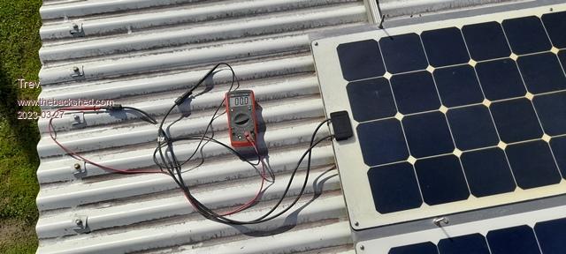

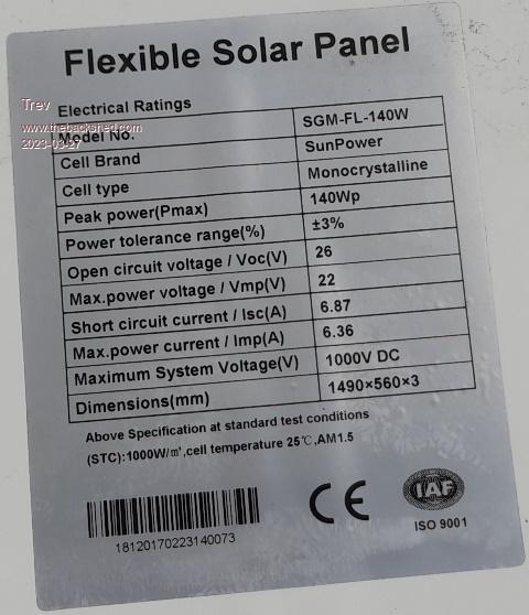

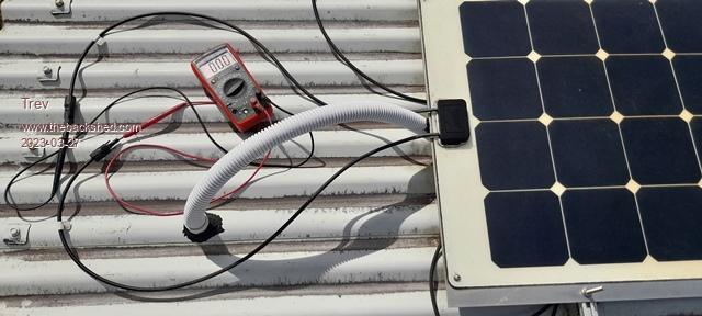

However, today I replaced 2 more panels (numbers 1 and 4) on the quad bike charge system. Both panels showed zero volts open circuit. So maybe 1 year and 11 months.
Panels 1 and 4 are replaced, photo from the other end.

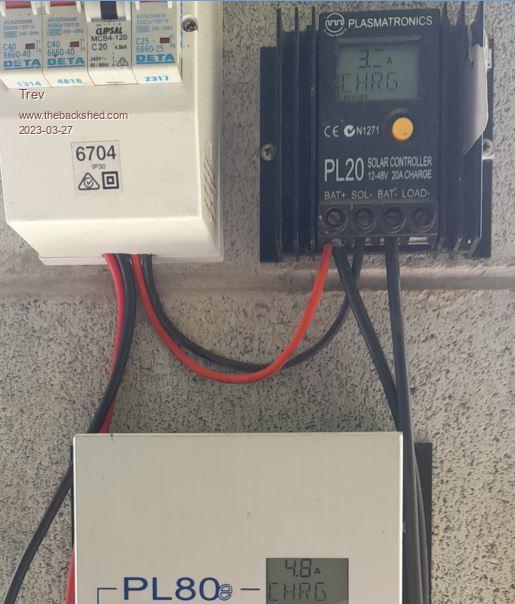

And charging again

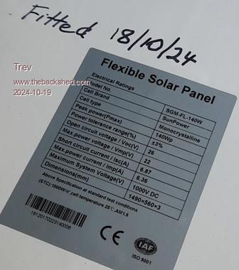

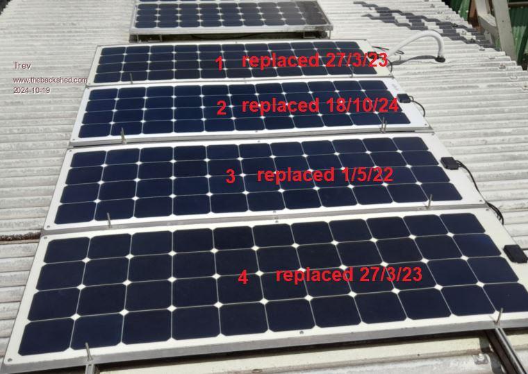

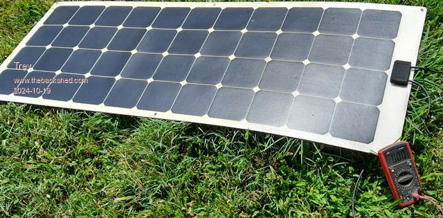

Another Sungold flex panel has failed. The one is labeled as No.2 on the picture at the start of this thread. This panel was fitted Dec 2022. That's 1 year and 10 months.

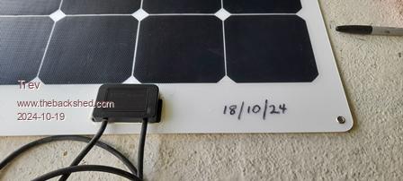

I wrote the date on the new panel to help me keep track of how long it lasts.
New panel fitted as No.2. And have written the dates on the picture when the panels were fitted
