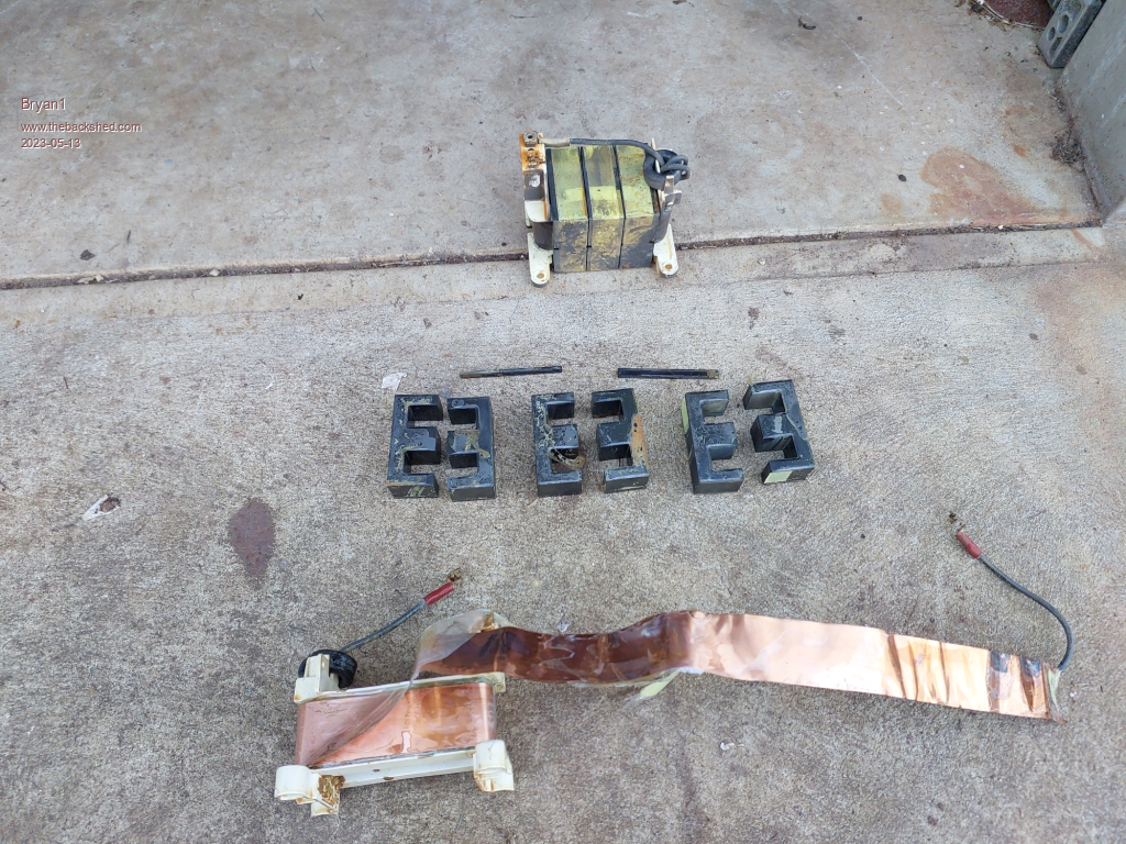

           Well had a bit of fun pulling this grid tie inverter apart and the big chokes were a huge surprise as instead of wire it used a a copper film sheet only 0.3mm thick. 3 off E-core sets held together with that yellow tape I have here and a spacer for the e-core gap.
Pic's to come later and I do think winding some of that heavy gauge wire on the former may be the go. It will be next weekend when my LCR meter arrives that PD gave the link to and I'll have to build that board then the real fun can start.

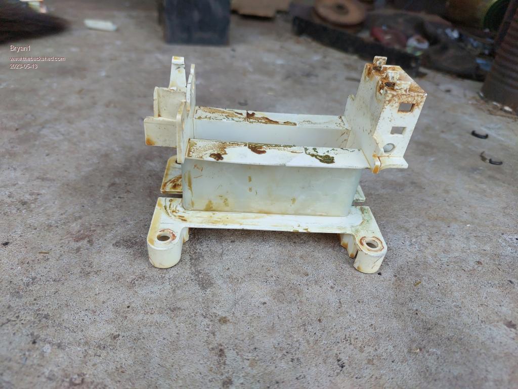

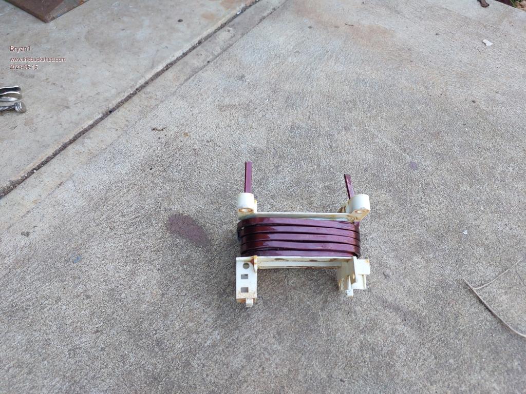

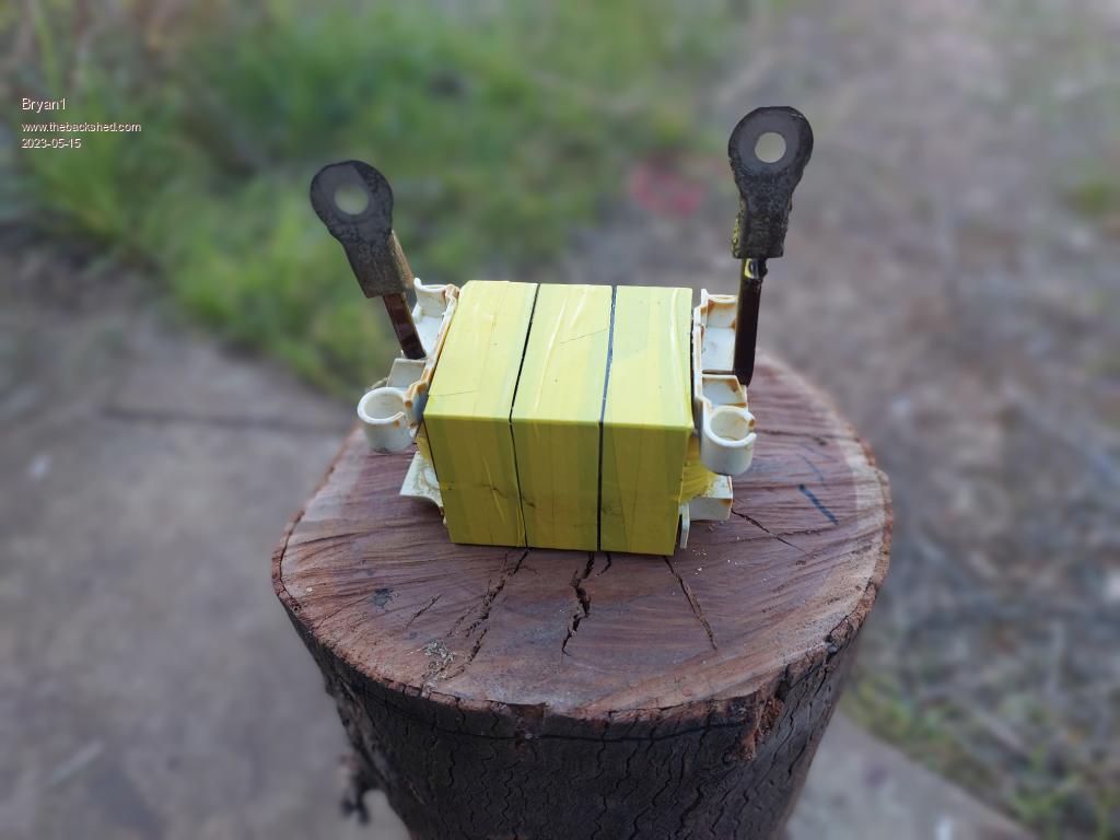

           Well stripped out that choke and found it had 9.725 metres length, 30 x 0.3mm in width. So with the former being 85 long x 25mm thick and 36mm in height gets us 220mm a turn. With the thickness of the former being 11mm I can easily get 2 and possibly 3 layers in for a rough total of 18 turns.
Here is a pic of the E-cores and the transformer and it does have spacers for separating the E-Cores.
Here is a pic of the former

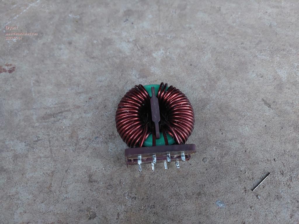

           Finally got that frontuis inverter all stripped and found this
Each side has 12 turns 2 in hand on and all the connections out at the base so it may just be the first choke I try.

Revlac
Joined: 31/12/2016
Posts: 1309
Posted: 08:07am 14 May 2023
That green one is a common mode choke, ok for the AC output, not good for a transformer primary choke.

Off The Grid
Murphy's friend
Joined: 04/10/2019
Posts: 678
Posted: 08:42am 14 May 2023
Bryan, the best you can do with that choke is rip off the wire and look at any markings on the core. Google them and if you find its a powdered iron core its useful.
Find two or 3 more of identical cores, stick them together, wrap some decent size cable (similar to expected primary current) around it and you have a good choke for an inverter. You might get 6-8 turns around it, depending on the hole size.
