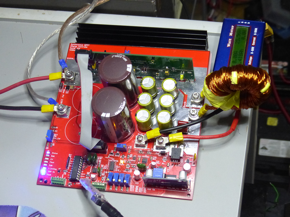

Am using 2 mosfets for the PV-Battery isolation switch, Buck stage and active rectifier, so 6 in all; the mosfet specs - bulk electro's determine the max input voltage and current etc. As it stands 40 amps charge current would be the limit using 1oz pcb. The PV setup for the pumps could generate 20 odd amps, have being doing testing with 30 or more amps for 1/2 an hour and the small heatsink gets mildly warm, haven't measured the actual efficiency yet.

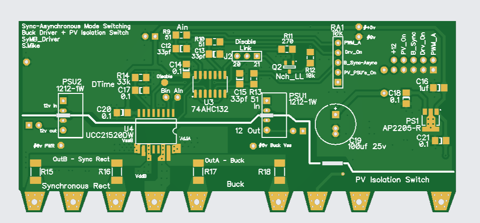

The mosfet driver circuitry has been placed on a small sub pcb that connects using a 10pin IDC ribbon connector, the pcb sits atop the mosfet leg pins, soldered to the legs protruding through the main board. This arrangement allows the high mosfet currents be isolated away from drive signals that now go direct to the mosfet pins, seems to work very well.

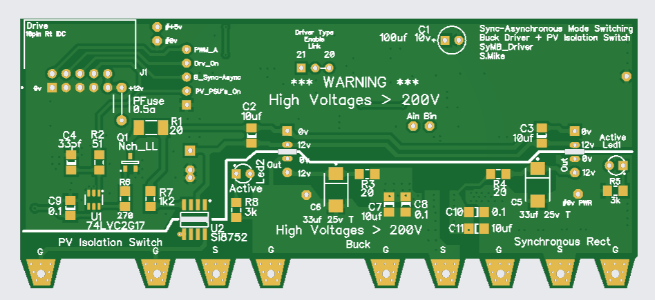

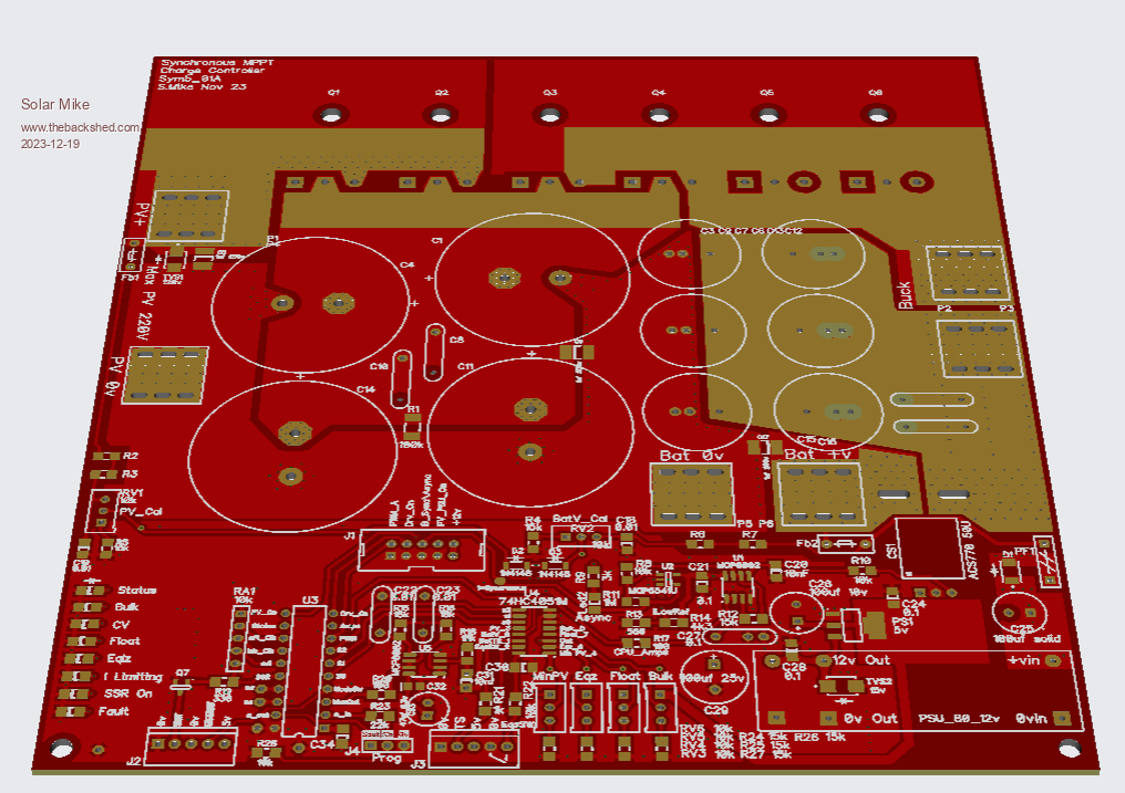

Main PCB 162 x 173mm:
Driver:

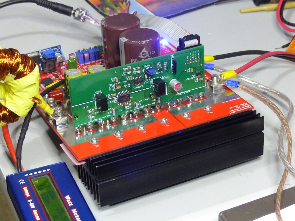

Assembled:

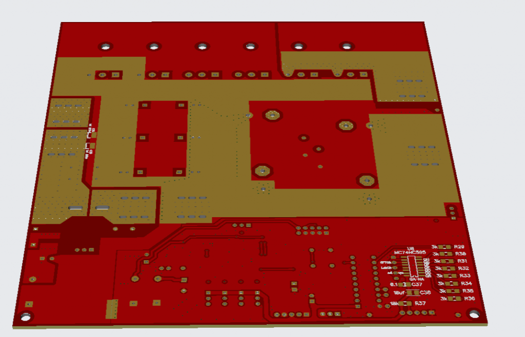

There is a wiring error on the pcb, PWM signal was going to a pin, that on the X2 version of the chip doesn't have a PWM output; had used the 20M2 in the layout rather than the 20X2. So had to cut a few tracks and run some jumpers. - What happens when you do all this in your head with no circuit dia.
Other than that issue, the main PCB and driver work well; I don't have a lower voltage power supply with high enough current rating to bench test at 40 amps and as I only fitted 80 volt mosfets for the initial test, cannot test it with higher voltages.
However Vers.2 should fix those issues, have fixed the wiring issue, changed the 0 volt earth plane so has more area and replaced the 50 amp ACS770 current sensor with a smaller 40 amp ACS723-40U. Would rather use multiple smaller controllers with their own PV array than a larger unit; much easier to make chokes and less stress on main electro's etc with lower currents. Also altered the driver pcb by removing redundant mosfet connections.
40 amps should be no problem using 1oz copper.
The PCB's arrived today, very quick turn around from JLCPCB considering the Xmas rush. Will build this up with some decent mosfets and see how it goes.

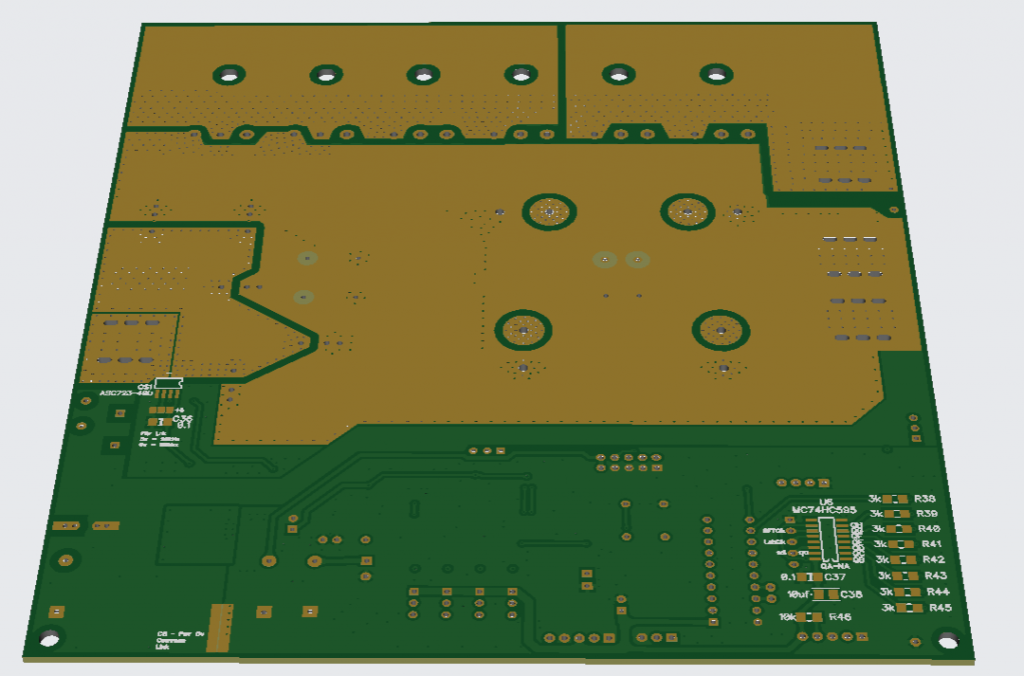

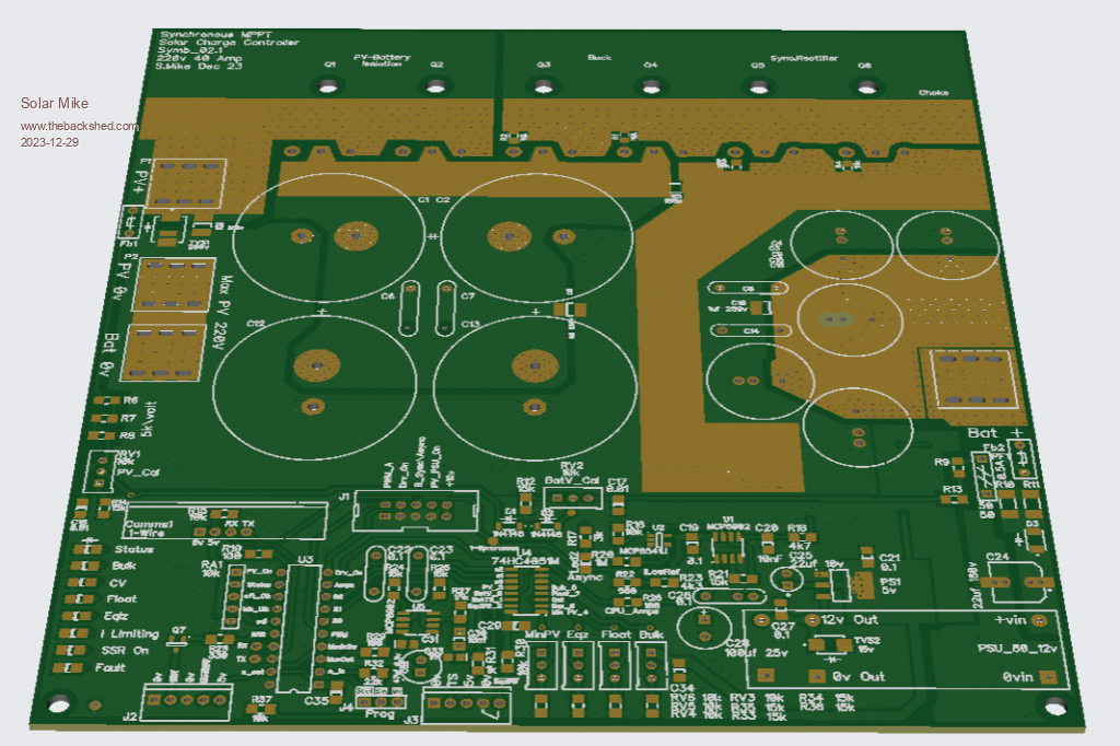

Main PCB V2:
Some of the white overlay lines looks squiggly, its an artifact of the 3D view only.

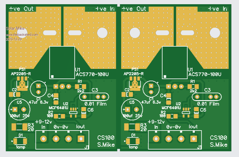

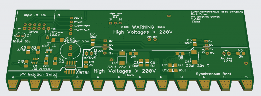

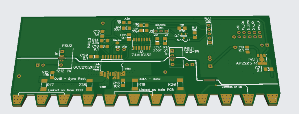

Driver V2:
Need an in-line current probe for my scope so designed this small pcb, has two boards, will fit with a 50A or 100A sensors, fit inside a small plastic box with 9v battery.
