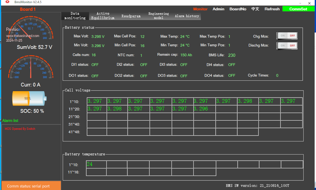

After many attempts at trying different wake up methods, most of which would wake up the BMS still did not turn on the mosfets, connected to the BMS with the PC software and could see in the bottom left corner a small message in red.......I guess that's the answer.

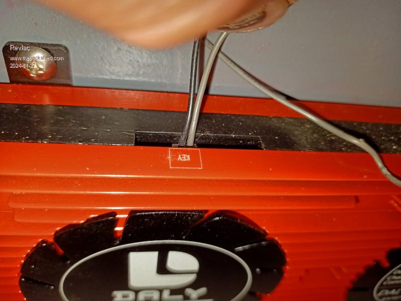

So I tried the 2 pins by shorting them with a switch and the mosfets switch on, but it want the switch to remain on or the fets will switch off again.....why they change this?
I did like the way the old ones worked with out the need for the switch, Having to use this switch might be very good in some situations as it makes it very easy to turn the power off ans stop everything, then its a good option to have.

The switch port, sometimes this is unmarked and in different locations on other versions of BMS they just love to keep changing things.

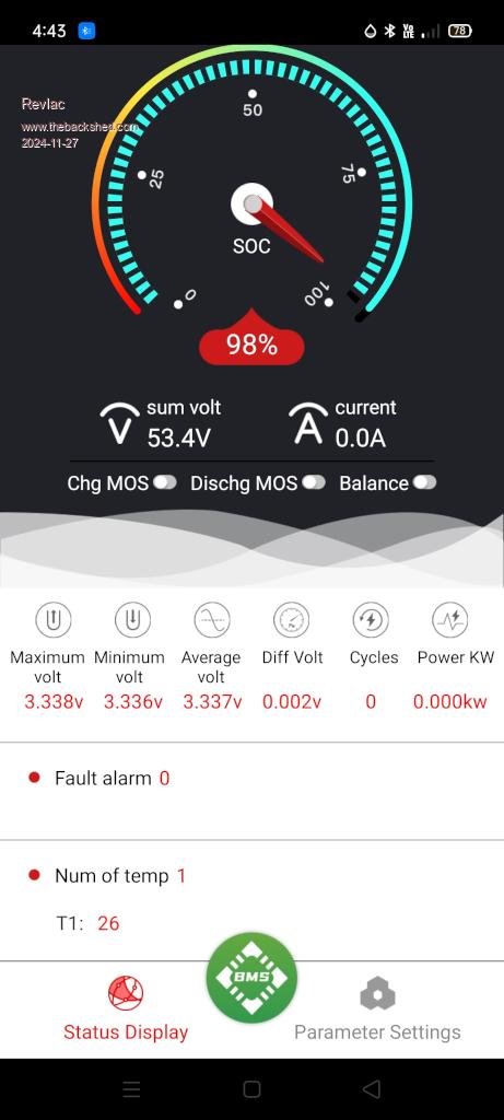

Ok the BMS will wake up easily, thought it good to show a pic of it on the Phone APP, can see the fets turned off.

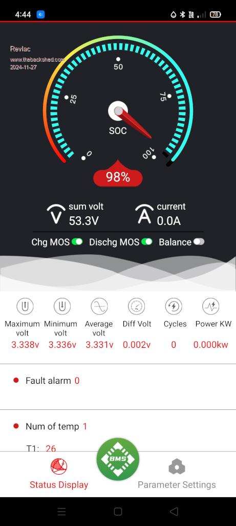

And now with the switch turned on, the green toggle's showing the fets on, still don't know if the BMS will do exactly as it supposed to, will have to test it with an over voltage cell trigger and see if the chg moss switches off.
