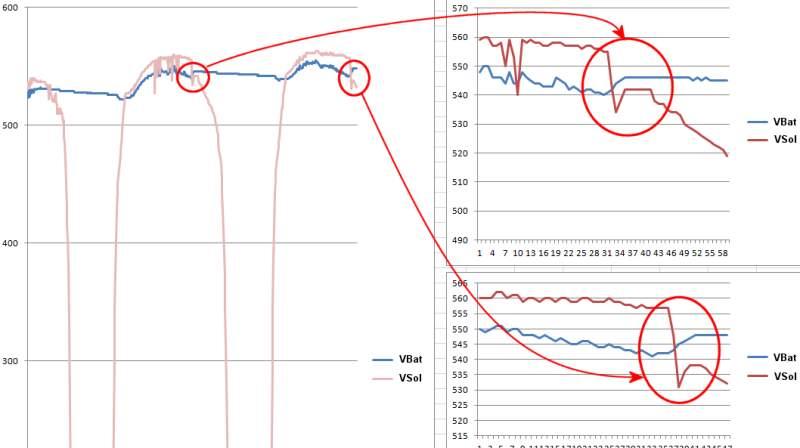

But I have noticed something unexpected that was not there with the previous schottky setup... it's not a problem but has really got me wondering. See the following graphic. This is a little over two days of charging (Y-axis is 10's of mV). Everytime the solar panel output comes off charge and VSol dips below VBat, I see a "rebound" in VBat.

Only a guess, perhaps the ideal diode doesn't turn off until there is some reverse current flowing. The rebound would then be when that reverse current stops.
Or it could be due to a change in temperature. The terminal voltage of the cells is affected by temperature, falling as the temperature rises.
When the cells are almost full much of the charging current can no longer be absorbed so goes into breaking down water in the electrolyte, making hydrogen and oxygen. As they recombine the energy is dissipated as heat.
Note how the battery voltage is falling faster than the solar voltage toward the end. Perhaps that indicates the cells are full and heating up. When charging stops the cells cool down and the voltage rises.
Some high rate chargers use the drop in cell voltage to switch to trickle charge.

I have had a day or two more to watch these traces and I agree the odd drop/rebound is almost certainly down to the switching of the ideal diode.
There is another, less pronounced, wrinkle at the begining of the day where VSol approaches VBat and starts to level out before getting a little kick back into the voltage climb. I think this might be down to the old schottky diode starting to conduct right before the FET gets switched on.
  phil99 said  ...
There is a fall in VSol which could be Temperature related or b/c the sun has moved round and is no longer perpendicular (but it is still very strong). I have another theory on the clearly related fall in VBat; Panel open circuit voltage (VOC) is inversly affected by temperature (T). Short circuit current (ISC) increases with T but not by as much ratio-wise, Pmax drops (manifests as a percieved increase in panel resistance) and dV increases. A whole charge cycle starts with a dV of around 50mV and ends with as much as 110mV because the panel is roasting in the June sunshine - If this is the cause, I expect this to reduce/disappear in the cooler months.
The sudden drop in VSol is due to the shadow of a 300-yr old Oak tree moving round and hitting the panel around 16:30 ish. The rebound in VSol is likely because it is no-longer under load as the ideal diode has switched it out(?)
