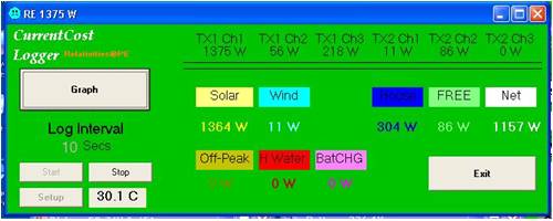

I have written my own VBcode to decypher the data output from the unit. You may wish to write your own. The intended purpose of the data, determins what is recorded.
I have writtten 2 versions myself. One records peak and Offpeak consumption and RE production. Another records solar and solar/wind RE production, and house consumption.
From the raw data, a swag of calculated data can also be graphed.
I have graphical output overlays of up to 6 data sets. Any more and things get cluttered. These graphs can be turned on/off as required, and trends from day to day, can be viewed with mouse clicks on the files.
The sensors only measure current, and not any phasing, so they read AC current as a positive number. The sensor has no polarity. It is pointless to measure the grid, as the meter cannot tell if the current is import, or export.
The total RE, and the total house loading at the same time is measured, and the net import/export is calculated.
I have a particular coding style. I record RE on channel 1, and house loading on channel 3. If you had the same sensing, then my program would give instant W RE production and house consumption, and net import/export W, updated with the latest data from the sensors. The historical data, collected and stored at 5s,10s,20s, whatever timing interval can be displayed on a graph. This is similar to the way Gizmo displayed on his piclog. I have added many features to allow rapid examination of daily data, current and historical, with mouse click selection. I have provided daily kWhr meters. that also work over any portion of the day. I also have a .CSV button, so the data can be exported for further analysis with spreadsheet/database etc. I also have quik select buttons, so portions of the day, and the last trends can be easily viewed with a click.
The program requires the prolific COMM driver to be installed, and mscomm32.ocx in the system. I have a program config file for port number, timing interval, and other parameters.

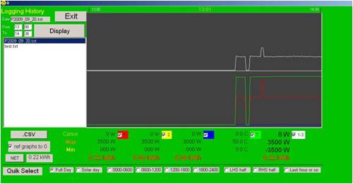

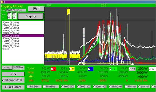

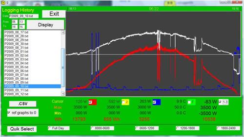

Bolty an I took a punt and purchased 2, with some additional clamps, on EBay. We were disapointed with the operation of the units. I put together some code and was able to record the data coming out of the display unit. It turns out that the data format changes at odd times and it was difficult to get an idea of the the task needed to make sense of it. I had a lot of trouble locking onto the data stream, as the string is sometimes over 1200 characters long. It turns out that most of the data is just retransmitted historical data, and is not much use.
I found a way of locking onto the start of the data string, and ignoring the rubbish, until synchronizing was achieved. Corrupt data still has to be found and ignored, without being logged.
here is a pic, of some test solar data
data can be viewed with single mouse click on the file list window. I think you can get an idea of what is possible.
The program that can be downloaded from the net was written in Python. The guy who wrote it is a programmer for IBM. I looked at the examples and decided to start from scratch.
Do you have one of these units, or is this all just hypothetical.

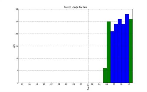

here is a screen grab of the old dates that i cant clear
has some large reading that skew my real averages
note i bought the unit today but it has data back to the 5th

looks a bit 2nd hand.

here is the data log reset procedure if anyone needs it
To clear all settings on the device to factory settings please perform the
following:
1. Remove the power lead from the monitor.
2. hold down the up and down arrow buttons and keep them pressed.
3. reconnect the power lead while the above buttons are down.
4. the display should show all LCD segments on, release the buttons.
5. the display should show two values 1. The firmware version and 2. The
amount of memory 1023
6. Disconnect and reconnect the power to resume normal operation.
All settings will be cleared including any tariff values that you may have
set.
