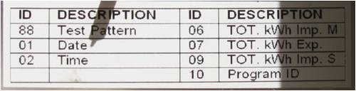

EDMI ATLAS 2000-1010
After reset it shows Kwh 's and because I'm on 3 phase ,I guess the 3 readings are from each phase ..
But adding these up is way over my useage,I think .
So , what I use per day from the supplier is what I'm most interested in ..

I'm mot fimilar with these meters as ergon energy uses Ampy meters. Although there should be an ID sticker/label on the meter which identifies what registers are programed into the meter and what they register.
The ID number is the number displayed in the left hand side of the display and identifies the registers, you can scroll through by pressing the display/select button.
There will be extra information displayed which is not identifed on the label. The extra information is usually line voltages, currents, frequency and instaneous power.
From my experience no manual is shipped with these electronic meters as each meter can be programmed differently depending on different tariffs and locations but there should be a ID Label.
The 3 readings that you are refering to are possibly Total kWh Import for each phase, if you want a daily total will have to read the meter daily and subtract the previous days reading to get a daily total.
