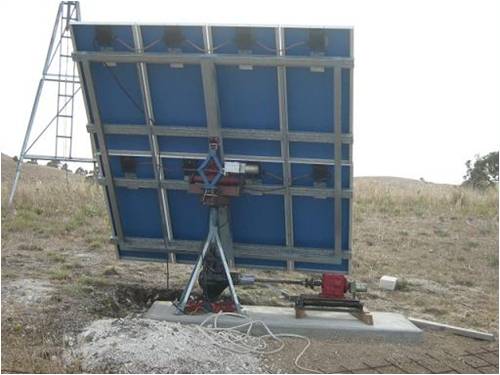

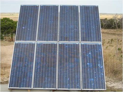

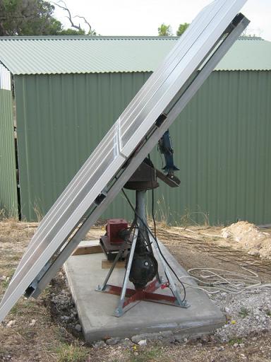

2 years ago i built a tracker for a friend who is totally off grid.
The increase in power was at least 30% and the power needed to drive it was almost nothing. It travels a 120+/- deg arc and back in the course of the day.
The motor was an 24volt dc from an old photo coppier (small) feeding through around a 400:1 gearbox reduction (just happen to be a bit of junk hiding under the bench) The high reduction prevents it being rotated by the wind.
This is then coupled to the input of a car diff stood on its end with 1 axle removed and the spider gears welded to make a locker diff.
The diff adds another 3.5:1 ratio.
The rotation is controlled by time and is moved in steps throughout the day and reversed back to the start each morning at a preset time.
We used two time cycles one for winter and one for summer. There was little to gain with fancy time periods throughout the year.
We also found that the tilt on the panels made bugger all differance throughout the year and is not adjusted now days (it did have a second motor on it)
We considered the use of light sensors tracking the sun but is of little advantage as the sun moves at a constant rate of travel and sensor systems only cause the tracker to hunt on dark days using more power.
The more crap you can keep out of the system the more reliable it will be.
It is not the prettiest thing i have built but it is robust and has handled some good wind forces without a problem.
The only problem has been caused by the owner not fitting the limit switches for an emergency position stop as it had worked so well.
A timing glitch soon showed the need for the limit switches. (about a year later)
Pete.

Pete, a question on your ingenious diff based tracker.
It appears to track the sun with the inclined panels rotating on a vertical axis.
I am wondering if this way is more or less efficient than having the panels rotate on an inclined axis (N,S orientated)?

Posted: 02:24pm 31 Dec 2009
There is a car jack stuck up the rear of the mount that had a geared motor on it for tilt. The whole lot pivots off the main centre beam and can be tilted forwards and backwards as well as rotated.
The owner choose not to use the tilt from trials done made little difference to their requirements and just another thing to cause a problem.
I do agree with your method and its well engineered.
The one i built was thrown together in a week over the Xmas break a few years back in pieces, so it could be easily transported 400km and errected.
It was to be strong and be better than what was in use at the time. (panels on a fixed frame in padock)
One of the best ways to get some idea is to play with a mirror at various times of the day, with the objective to direct the light straight back to its source and note the mirror angles required to do it.
One soon gets a mental image that any tracking is better than none.
I did read your thread some time back but how are you controlling your system.? (could be a good picaxe project )
Pete.
Pete.

  VK4AYQ said
I found that smaller trackers not cost effective on a 30% return on extra power as it cost nearly6 the same to make a small one as a bigger one.
Moral of the story if you have got 6/8 panels buy two more its easier unless you can do all the work yourself. This array was used with 20+ panels then the effort is worth it.
All the best
Bob
Yes Bob, but does one include cost in the process of enjoying tinkering out a working tracker for the first time?
In my case it was well worth the challenge and it turned out not expensive either, using mostly scrounged parts that were stored in the shed for years ..
Bigger trackers require more solar panels and that is where the real expense is, IMO anyway.
Klaus
