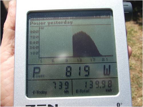

My concern is with the functioning with the Sunny Beam display which does not seem to show any 'Energy' produced, either on the chart view or the energy display, between the hours of 7am and 11 am on a daily basis.
The display on the SB1700 seems to be functioning correctly at this time with the current instantaneous power, daily energy and total enery being shown.
Only the instantaneous power displays at this time on the Sunny Beam.
When the chart view starts operating at 11am it does not include the power produced from 7am. The total power is not updated until the 'Power Yesterday' display on the following day, although the chart view remains the same.
I have thoroughly re-checked all of the System Settings which appear correct (including Time, Date, TZ etc)
Eventually I resorted to a full reset but this only produced a full display for the first day, after which it reverted to the missing data display.

Yesterday I downloaded & installed firmware update V 01.07.06 from the SMA website.
This seems to have rectified the power graph problems although I have not had time to check all of the other functions on the Sunny Beam with Bluetooth unit.
