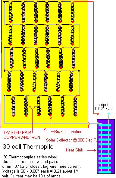

I drew this up as a memo to my self, working with something for a while helps me remember a few details about what I've been checking out. So I will remember no volts, Good Amps.
It would be interesting to put a couple thousand together and cook um in the california Sun.
May need some concentrating Mirrors to get 300 deg.
The hotter it is the better it works but again, Not by much.

I actually did something on the order of your little picture about 35 years ago. i used copper and iron and it did work, but was grossly inefficient. As a plumber, I have a "special" meter for checking 24 milivolt thermocouples in water heaters and space heaters and using it to check the output of my home-made contraption, the thing didn't work as well as merely tying together about 1/10th as many "commercially manufactured" thermocouples! The commercial ones are made of actual semi-conductor materials (I should know, but don't!).
I like the idea of the TEGs and will likely lean in that direction as I further investigate this phenomenon. I have a friend who owns an electronics shop and he has a "bone pile" with one of everything and two of everything else. I"m going to take a swim through it (the pile) and see if I can find some semi-conductor parts like those shown on the TEG Power.com site.
Thanks for your efforts.
