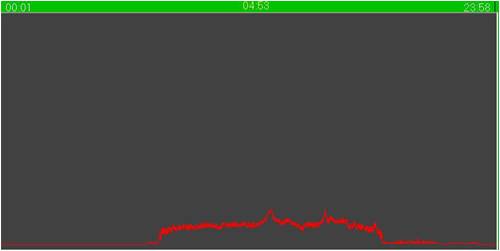

Hi neil0mac,
Yes, the 4kWh/day average does sound low. Perhaps, this is 4kWh/day export, or 4kWhr/day/kW solar.
The figs I recorded, were at a time, I manually read all my ETSA meters each morning.
For the last week, my system has produced
8.0,4.3,3.4,11.4,12,14.7,13.8 kWhr/day. This is now a rated 3.4kW system, so is still making up to 4.3kWhr/kW solar. I am at Lat 35.5, and my panels are aligned 15 degrees max. 1kW is operating but not mounted on frames yet.
The 4.3, and 3.4kWh days were overcast all day and looked like this.

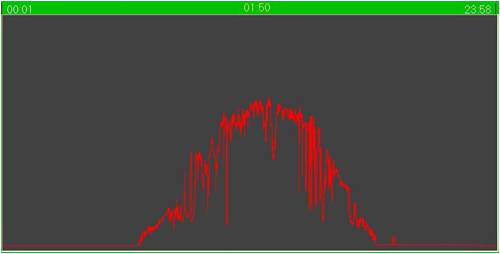

This was the 13.8kWh day, with intermittent cloud effects
Since I have increased my solar to over 3kW, I have not seen over 3kW produced. There is some interaction problem with the inverters and the grid, so the max power plateaus for a couple of hours on the really sunny days. Most of the time the output is not affected, and the panels produce the appropriate rated power.
