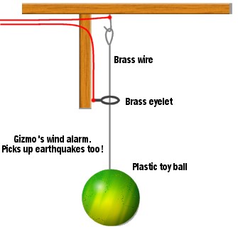

Oh and lastly Gizmo -beauty a simple solution that i think would work but to do what?
Park it in what orientation?
