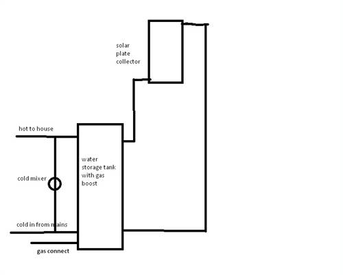

Hmmm, if the collector is setup as drawn than the cold water needs to come into the bottom of the collector and not the top as shown.
Hot water rises remember.
What is the collector coils made out of as you will need to support them so any water hammer effect from washing machine solonides etc dont rattle them to bits with time.
If its plastic pipe than this wont matter...copper will.
You might want to include a check valve on the return path so you dont get reverse effect during the cold nights or it might cost you more than you save.
Im not sure on how well it will work because the collector will need to get to a temp hotter than the water heater before you will get any thermo siphon.
I still think the 2 heat exchanger coils is a better system as this raises the temp of the incoming water before it gets to the heater, weather its a 1% or a 100% increase it is always a gain where your system might sit doing nothing most of the time. Or worst still, actually cool the water if designed wrong.
The more i think about this the less i like it because it is really designed ass about.
If the heater was on the roof and the collector was on the ground then it would work as the hot water will rise but you want the hot water to go down and the cold to go up and something tells me this might not work.
Ever wondered why a solar heater has the tank above the solar collector??? ...tip... it aint for looks.

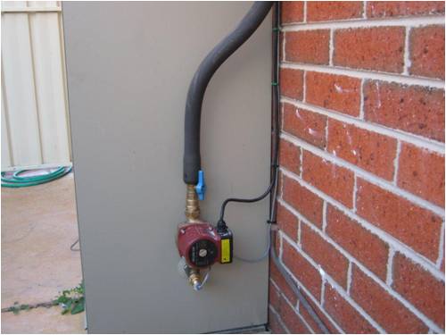

Whatever you do, do yourself a favor and build a 3-valve "H" pattern isolation valve setup so you can isolate things and leave the water on in your house. I had a system for the panels and another one for the tank, so I could fiddle with just about anything and not entertain complaints from the peanut gallery (wife).
If you wind up using a Grundfos (brand name) pump as is pictured in the link you posted, be aware that this pump is designed to be mounted in the horizontal position. Mounting it any other way will ruin the thrust bearings in a year or less.

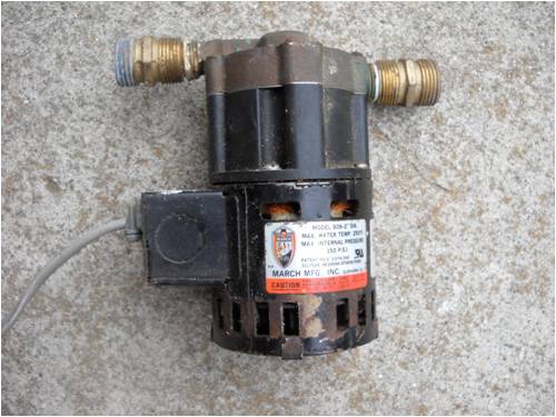

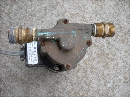

Hope that helps you out some. I'll be back later with the pump picture. Here ya go:
This is the 110 VAC pump. I have "hose" ends threaded on now. I cannibalized
it to be able to hook it to a hot loop I built on my water heater. I allows me to
use the heated water in my garage water heater to pass through a fan-forced
fin-and-tube core and heat my workspace when I take the time to hook it up
(seldom-just lazy!).
This is an end-view. The center is the inlet and the other one is the pumped
side. Get this backwards and it's just a paperweight!

Just a note regarding Mac's warning about connections.
Here in Aust. most heaters are made with universal in/outs so one left and right so they will replace either previous brand.
The extra connections you ask about using is not the same plugged fittings that Mac was talking about so should be fine to use.
Even with a pump i would still use a check valve to stop the hot tank water rising up into the collector.

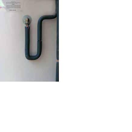

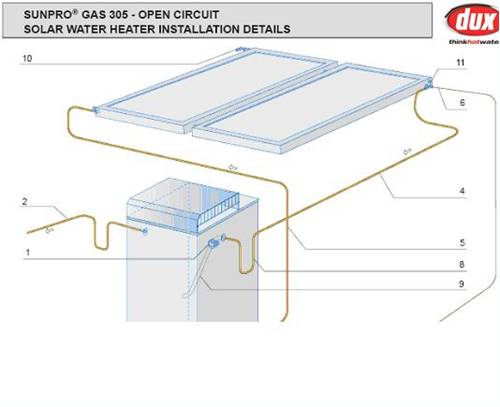

ok guys why the bends (dropped loops) on the inlet and outlet to the HWS ???
item 2 and 8
Edited by rgormley 2010-04-16
Loomberah
Joined: 11/06/2008
Posts: 43
Posted: 04:57am 15 Apr 2010
To accommodate expansion and contraction! As the pipe heats up and increases in length, its going to put a lot of stress on the connection to the HWS, a U-bend eliminates much of that stress, as the U opens and closes instead.
Loomberah weather +solar&UV, astronomy, photography, organic farm
GWatPE
Joined: 01/09/2006
Posts: 2127
Posted: 05:02am 15 Apr 2010
Whenever you plumb with rigid pipe there should be a minimum of 3 changes in direction between any 2 fixings, to allow for movement in each of the 3 dimensions that occurs with changes in the differing thermal expansions that occur with cyclic temperature transients. If you don't then the pipes will fatigue crack over time.
This is achieved with the combination of the 2 elbows, and the U.
Basic plumbing 101.
Gordon.
become more energy aware
rgormley
Joined: 22/02/2006
Posts: 245
Posted: 05:03am 15 Apr 2010
thats what i thought also....
Also interesting i found this in the dux install guide
Care needs to be taken when running flow and return lines through the eaves. Flow
and return lines should be neatly installed. return line must run horizontally to the
tank (as pictured) NOT directly vertical to the solar return socket.
• This prevents reverse thermo-siphoning. I.e. hot water loss where hot water moves
from the storage tank to the collectors and storage tank heated water can cool[IMG]uploads/rgormley
