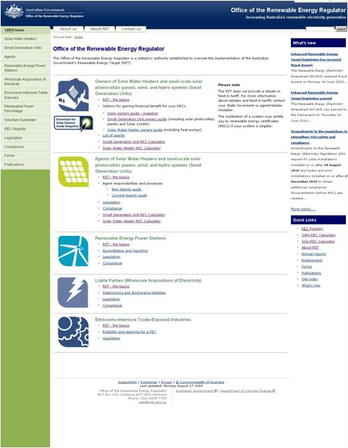

Neil, you're not really helping, can you be more specific? I say this in reference to your comments: [quote]The 'official' fprmula is found on the government page I gave you. Go look again. [/quote] and [quote]Again, see above. Use the lower set of figures on that site. [/quote]
for instance, the only reference to any link you have in your post is: orer.gov.au
Mate I have spent a lot of time ON that page, and it's just as confusing as before.
I have looked at it and tried to comprehend that page, some of the links from that page and then even some of the PDFs from those links form that page. I must not be seeing what you're seeing. Please provide a link to what it is you're talking about.
I don't see any figures or formulas at all :-( In fact the only formula is their calculator which is only part of the equation.
this is what I am seeing:

On the above page, there is a link to Small Generation Units.
http://orer.gov.au/sgu/index.html Click on the RECs tab. Simple.
madivad
Joined: 02/07/2010
Posts: 5
Posted: 01:15pm 02 Jul 2010
GREAT LINK! Thanks Neil. I'm actually in the part about doing it yourself, doesn't look too hard (he coughs) ;-)
