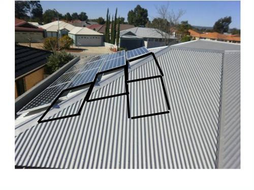

This is roughly what I had in mind, obviously not sitting them flat but jacking up one
side
Problems are as follows
mounting rails must run with the panels and ~300mm (width of panel is ~1600) in from the sides
rows of roof beams (ie screw lines) not well suited to this.
in order for the panel to sit roughly flush with the roof at the apex to the NTH face
BOTH rails would need to sit up off the roof, complicating it further. as brackets are designed to fit ~90 deg to each other

Could you extend the exising mounting rails? Take all the panels off and extend the rails out one or both sides, then mount them all back on with the extra panels down the side.
Or what if you monted them all at 90 deg, portrait instead of landscape, short side top and bottom. They might nest together better.
Posted: 07:10am 01 Aug 2010
Why place them at the top of the gable and not start down near the gutter and work your way up.
It would require some unused rail lengths, but the extra rail area would allow for some fill in panels to be added as they became available in time.
I would be doubtful the small difference would make any difference in output when you concider the distance between the roof and the sun.

Glen,
i considered that but it involves another yet another $500 in rails
and more importantly the batton spacing doesnt allow the two new rows
to butt up against one another like they do in landscape, thus loosing more space again.
I considered this
but as far as anchoring the tops of the rails to the existing screw lines its an absolute nightmare and hanging out in free air is a big looser!

Karl, if what Glenn suggests does not work then do not place them as illustrated, place them along the line of screws. one thing in your favor in WA is much of our winter sun is in the afternoon ie wnw. Be careful about exposing panels to the sumer ESE winds and winter westerly's without strong mounts.

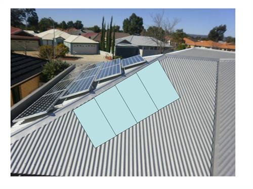

Hello Karl,if you add the 4 new panels abutting to the left hand end of the North West array shown in previous post and angle them back to more or less match the North facing array.Yes you will need a frame but would look pretty neat I think.If you need a hand let me know.I tried to import a photo from paint but you can guess what happened.
Well done on your systems excellent installation.
Anthony.

Solved!
Expensive but elegant none the less
ARRID bits trade money...still EXPENSIVE but
hey I look I the bight side that is 740W more panels
for the bargain price of $2500 All UP.
now I (will) have just under 5.2KW
after RECS should be out about $1900 which for 740W is
a bargain!

Going to look like sketch 1 in the end pics to follow soon
