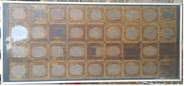

I have a solar panel circa 1985.
This is what it now looks like, and has approx 10% of original current output.
This is a poly crystalline panel, of nominal 55W output when new. It now has a nominal 5W output, after approx 25years.
There is some corrosion of the busbars, through water ingress associated with shrinkage of the EVA/tedlar back layers around the electrical connections, [although the screw terminals are still OK]. There are bubbles in and discolouration of the EVA. The cells had the blue NRL coating. The panel spent over half its life in the tropics, and has deteriorated significantly in the last 4 years in a temperate climate. Not all the cells are affected the same way, as can be seen in the pic.
It would be interesting to hear if other readers who have had a long experience in solar, have similar panels.
These panels looked fantastic and had great output when new, and cost over $1500 ea.
Can get about 1kW for the same money now.
Gordon.
