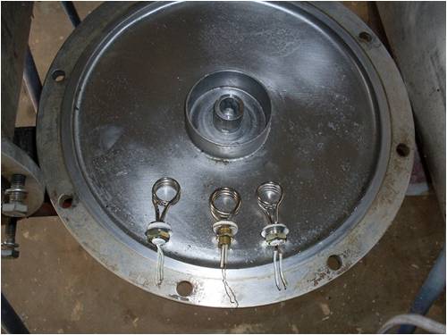

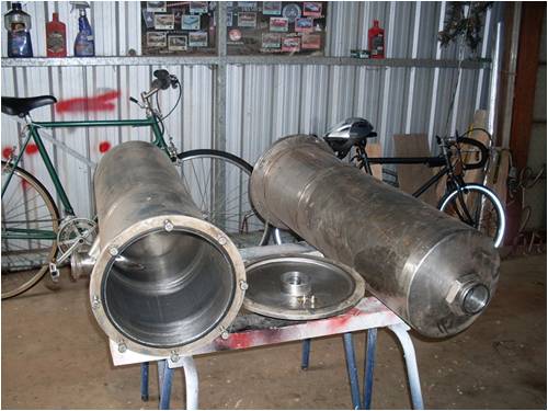

I managed to score these stainless steel tanks out of the scrap skip at work. Which i plan to use as a preheating set up inline between the mains water and my existing hot water servive.
These elements from 12V car kettles i plan to fit as a dump load from my wind mill, which at the moment wont contribute a great deal to heating the water, but as the wind mill developes the out put should improve. I plan to add a home built thermo-siphon solar collector which will do the majority of the heating.

Nice find there mate, I tried out those little heating elements but found them to be a bit fragile as they tend to blow if the voltage climbs to much.
In the end I made a element out of a strip of stainless steel .5 mm thick by 1.5 meters long, it worked good on 12 volts as a dump load suspended in water. I got it from a sheet metal shop as a strip off cut, cost me a six pac.
I wound it on a piece of earthenware pipe as a former with holes drilled to terminate the ends.
All the best
Bob
PS:- the reason for my concern with the little elements as a dump load is if it is dumping and one goes out the other two will quickly follow and then you have a runaway mill.

I have been wondering how durable these elements would be. i would like to get a nice big 12v element but they are not cheap. The only problem i have with making up the element is termiating through the tank and geting a good seal on them i would need to use a non conductive seal where the bolt goes through the tank. Maybe not that hard to do. The tank will be presurised to mains pressure.
All the best Dean.

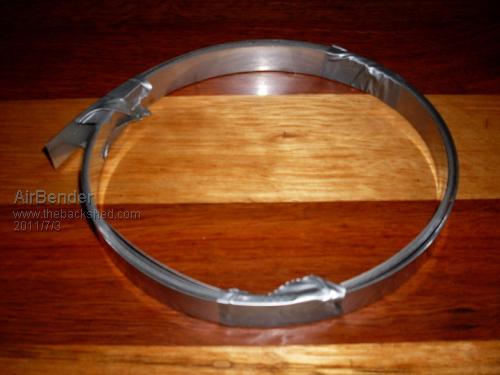

Thanks Bob, insulating one terminal makes it easier. with your stainles steel strip rouhly how wide was it as we have plenty of stainless scrap at work so i should be able to get hold of something to do the job. I have enough bits at home to put together a second shunt regulator so i might add a secondry shunt as back up, which should help prevent overheating of wires and components and would be handy if the mill gets bigger down the track.

It is an edge strip off a 2.4 meter sheet about 15 mm wide, in hind sight I should have left it full length but a bit was cut of before I made the shunt and I didn't have any argon for the tig to weld it back on. It absorbed over 100 amps on the 12 volt system around 1.5 kw from memory. I used a similar set up to heat oil for a solar steam project in the past and found that a flat strip heats the liquid better due to I think the larger surface area.
I got some strips of Chinese SS a while back but where no good as they developed hot spots due to allot changes in the sheet. 204 I think. The original is 316.
I used some of it as a series resistor for my old tig to get the amps down.

I was given a .5 mm stainless steel strip by a lagging contractor at work, very kind of him, he said he has plenty of it back at his workshop.
I think I have come up with a good idear for the former, but this progect will need to go on the back burner for a while as i have a few other things on the go. But getting the parts together is half the battle.
