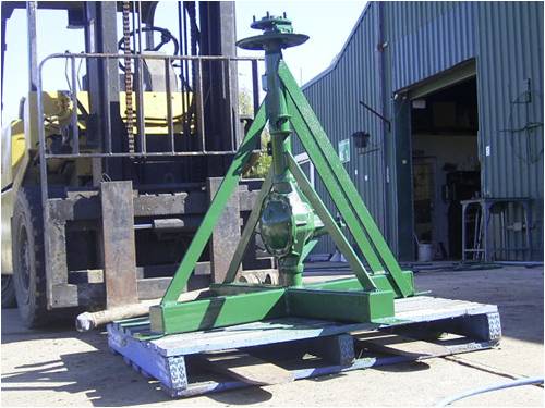

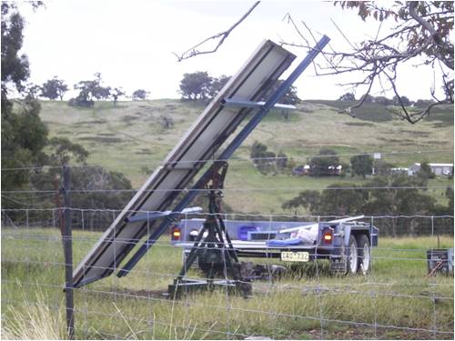

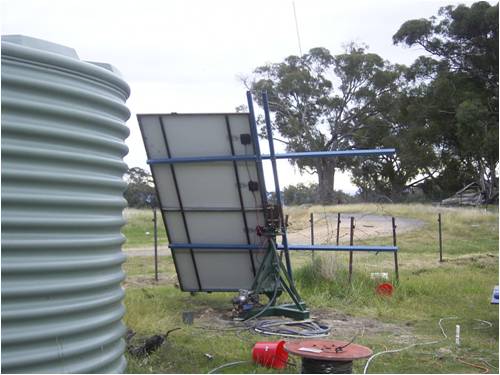

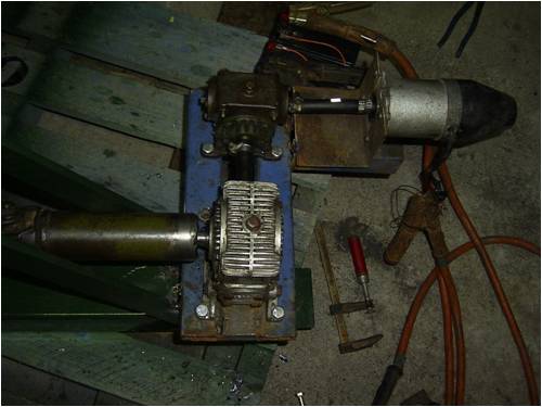

Posted: 08:19am 31 May 2011
Hi Mac46, I to am a farmer born and breed. I was raised on sheep and cattle untill the vineyards came into the area. I have managed a 250ac (90HT) vineyard for 17 years now and still live and work the family farm. I think over time there has been alot of idea's come from farmers.
There is alot of info I have posted on the Picaxe Forum.
http://ozelecforum.com/
Here are a few photos of the set up..

Posted: 10:14am 31 May 2011
Excellent job.
Thats a great achievement.
Thanks for posting those pictures.
I have heard mention of using a car diff for a solar tracker, before.
But never seen pictures, and I always wondered exactly how it is done.
Thanks.
