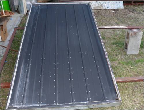

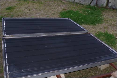

Below are some Pics of the Solarhart L-Series panels that I bought for $60, you would not be able to build them for that, and with the good quality low iorn glass and aluminium enclosure.

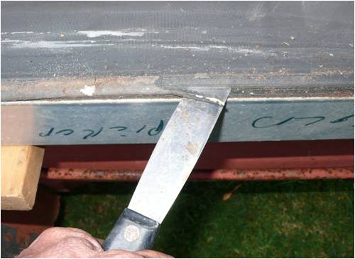

Removing the Glass with a scraper as it is assembled with double sided tape. There is an alu angle edge that is easily removed by drilling out the rivits to get to the glass.
This shows the collecter with the glass removed , this panel is why they were removed as it has a small pin hole in the top tube which can easily be soldered .
Shows both panels , they are easy to remove by removing the corner rivits from one side and bending the side out to slip the panel up and out.

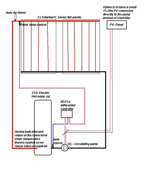

Below is a basic scematic of how I am going to connect them to my existing Hot Water Cylinder

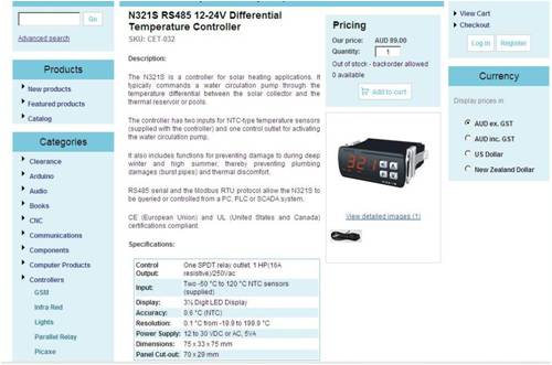

This controller can be powered by 12-24vdc/ac and costs $89 and comes with the sensors

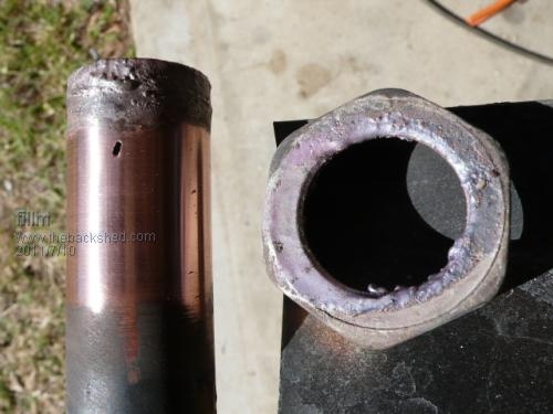

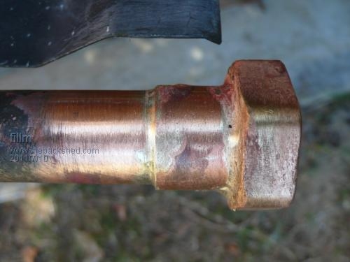

Anyway some progress on the rebuild , the pics below are of the repair job I did on the pin hole . I could have just soldered over the hole but opted to sweat the end off and use 1/2 a 25mm joiner to sleeve the suspect section .
Shows the hole with the coupling sweated off
Repaired , pressure tested and ready to go.

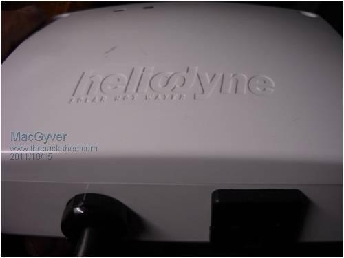

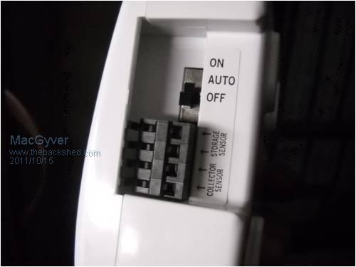

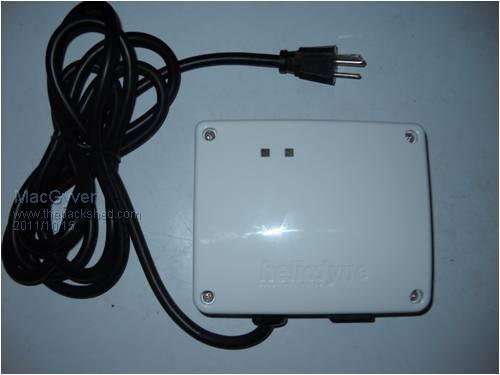

I took your advice and purchased a delta T controller online from altE It was a little pricey, but it's my kids' inheritence, so I won't tell if you won't. Seems to me from memory at least, it was around $125.
I haven't installed it yet. It's a plug and play and the only wires I have to run are the two to each of the temperature sensors. One goes on the solar panel and the other goes on the receiver tank. There's also a feature that runs water through the panels should the air temperature fall below 42*F.
Here are some pics of the contraption:
This is it just out of the box.
The leads were a separate purchase at around $7 each.
"Heliodyne Solar Hot Water"is what it says.
Maybe this will help someone else trying to do the same thing as we.

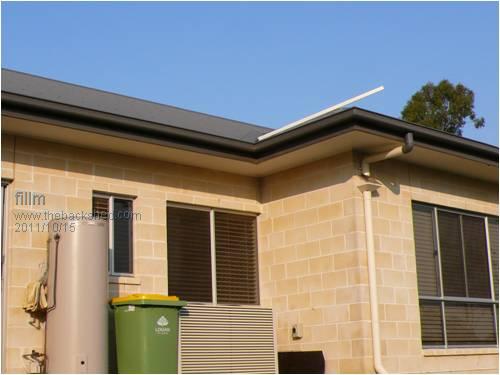

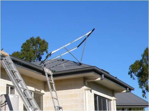

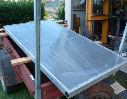

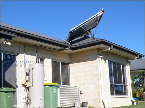

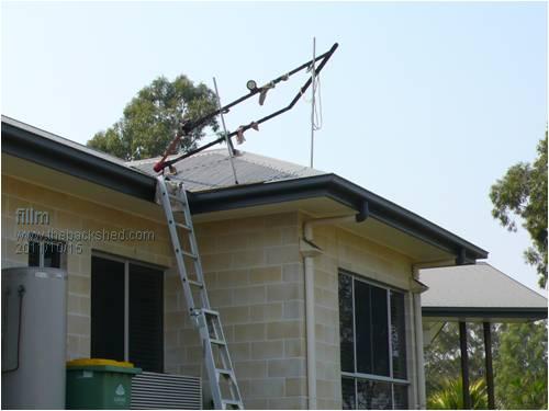

This is where I complicated things , because the roof directly above the hot water system is 45deg east of Nth I decided to face it true north to get the best efficeincy, this brain wave turned out to be bigger than Ben Hur .
Setting up all the angles meant countless trips up and down the ladder which gave the old legs a work out.
The frame up and painted ready for the panels , the second ladder was used to slide each panel up on . Working on a 25deg pitch needs good grip and the old dunlop volleys are like suction pads on your feet .

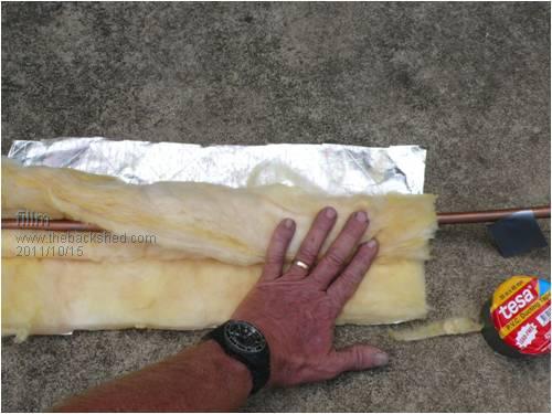

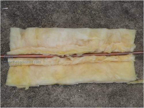

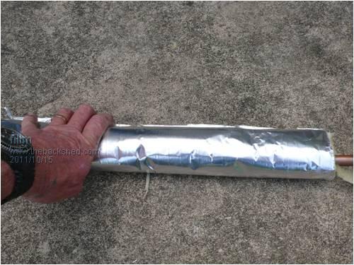

I priced enough of that black foam pipe insulation and it was going to add $120 to do all the copper tube, I scored some left over roof insulation wool from a house being built accross the road which I also used to put a new layer of insulation under the flat panels before putting them back together . I decided to use it to do the pipes as well. Cutting the wool into smaller pieces seemed to work the best and it was like rollin a giant smoke for those who used to smoke . Halving some of the wool layer over and then putting it under the pipe first.
Fold the top wool over leaving its foil and then the bottom wool and foil
Then fold the top foil over and have some duct tape tabs ready to hold it , then wrap it with the duct tape, I think I went through 3 rolls of tape and by the end I was getting pretty quick at it , probably took about 3 hrs to do all the pipe work which was a whole lot quicker than fitting all the pipes before the insulation was fitted . The wool and duct tape doesn't look the best but it sure works!

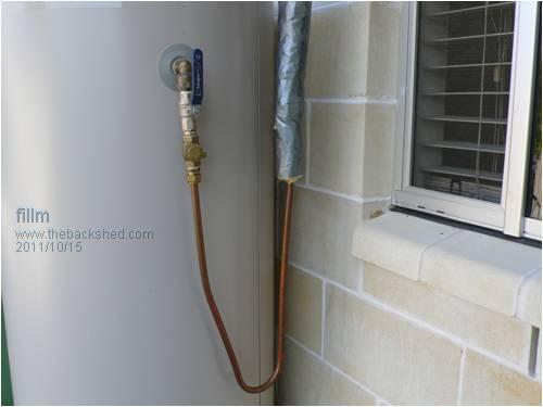

All plumbed up and going , origionally I was told by the experts to plumb the inlet and hot return at the same level at the bottom of the tank ,I tried it but with this tank it could not be done the makers have a tube that seems to join both inlets accross between the two inlets , the hot water coming back from the collecters was being drawn straight back into the pump inlet so I put the return into the spare top hot outlet, this caused a bit of head scraching befor I found that one.
I also fitted a check valve on the hot return to stop thermosyphon at night , I was also told if you put a U in the pipe it would stop this bit it didn't , the check did the job .

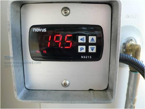

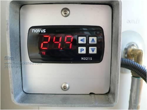

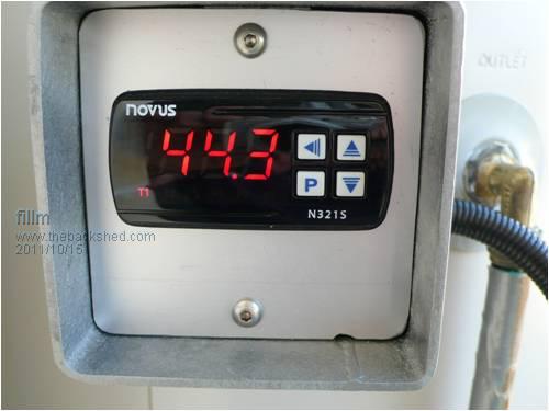

These next three pics are the differential controller taken about 9am and its doing its job
T2 is the inlet temp
T1 is the temp at the top of the collecter
T1-T2 the Differential , when it gets to 20degC the pump turns on and the remains on untill the differential gets to 18deg . I had a lot of problems with temp lag in the sensor at the top at first because of air not transfering the heat to the sensor probe quick enough , it needed heat the transfer gell and then works like a charm .
The controller is fully programable and 20deg is the Max Dif .
