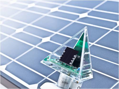

this is my all time favorite mainly cos it looks so fricken cool!
its called the DEGERconecter and I have never seen one for sale so I assume that it can only be bought as part of a tracker array kit. they call it a maximum light detection tetrahedron DEGERconecter

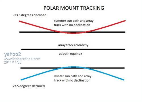

There is a third option and that is to make it a true polar tracker, that would mean a bit more fabrication. But then it will track the suns path very closely with one motor and some seasonal adjustment and fairly simple electronics.
It is hard to describe,weld the turntable at true north, then you lock the elevation to suit your latitude suns angle on the equinox 20th of March and 23rd of September (these are the days that it will track a straight line across the sky)then fabricate a elevation axis ABOVE the right ascension axis that only moves the panel angle 23.5 degrees up and 23.5 degrees down for seasonal correction. This makes the panels trace a curve across the sky. This is called declination. The big advantage is a constant 15 degrees per hour (of right ascension) is all that is needed to trace the suns path, the declination motor only moves once per day to change the curve.
I have done a diagram that shows a where a standard single axis tracker (with seasonal elevation adjustment)loses the sun, its mornings and afternoons. You might get the concept quicker than I did. I was trying to track inclined orbit satellites, it is a bit like catching mosquito's in the dark I could tell I missed but that was about it.
the summer and winter sun is the coloured lines. Standing facing north and looking up.
