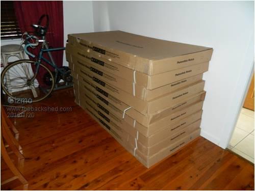

These were bought from forum member Trev at Basicly Natural. There are 2 175W 24V panels in each box, and 6 boxes are for me, the others for someone else.
12 panels is 2100 watts, which should be enough to get me started.

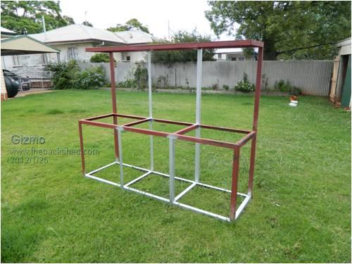

Today I started on the battery box.
It was an old bench I picked up from my Dad. I added the new steel seen in silver zinc coat. I still need to grind out some rust in the original frame, then paint the whole thing.
The bottom half will be enclosed with doors on the front to access the battery bank. I positioned the shelf at ground level to make it easy to lift the batteries into place, and stop snakes hiding underneath. I'll use plywood to enclose it, line the bottom with a rubber sheet, and add a few 100mm ventilation holes top and bottom of the back panel, covered with mest to stop mice, etc.
The top half will have a backing board with the inverter, controller, etc mounted on it.

That's going to be very nice. I will also be building one in a few months. What type will you paint the metal frame so it can withstand corrosion? Epoxy?

Philb I was just going to give it a few coats of enamel. There is already some possum pee corrosion on part of it, so I dont expect it to last forever. What I am concerned about though is the effect the fumes may have on the wall of the shed behind the battery box. I might try to duct the fumes outside. If I run a 4 inch PVC pipe from the box, up the wall and outside, the natural convection will keep the battery box hydrogen free and the fumes outside, in theory.

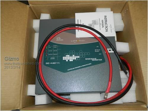

Today I picked up the inverter. 7kW 48V Latronics. Heavy little bugger!
I wont buy the batteries until I'm ready for them.

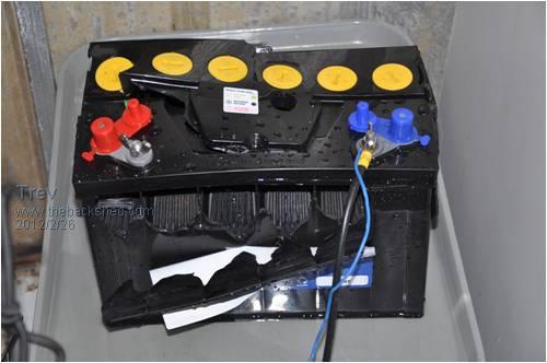

Hydrogen is lethal when ignited, so care must be taken to keep the hydrogen and sources of ignition separate. Lead acid batteries are the problem. Wet cell worse than sealed AGM. Here is a picture of my younger brother's brand new deep cycle battery he fitted to his 4WD.

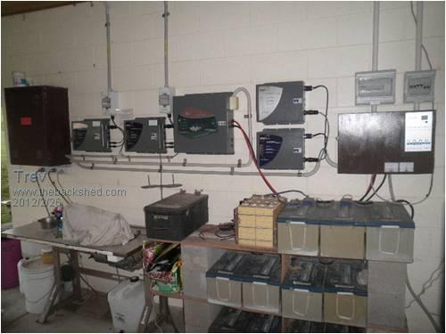

I agree 100% Bob, batteries and electronics all in a small shed is a no no. I got called to check a job from another installer. Everything was in a small garden shed.
The shed was still there, but the wire size was too small, obviously had been over heated, particularly the connections. The batteries were stuffed, run flat. And 8 of the 12 panels had failed. This small shed was at the back of the house, just out from the kitchen. This was a disaster waiting to happen. If it blew, I think you would be cooking more than steaks.
Here is a picture of my setup at present. This is in a very open breezway beside the carport. Some readers may recognise the batteries. They did 10,000km in the EV Hilux and replaced with Lithium when they arrived. These AGM's are still very good.
Philm the last of the black CAT batteries died a little while ago (on the end disconnected). I have my 200ah Lithium camper set in its place, connected in series with the top row of AGM's and parallel with the rows of AGM's below.
