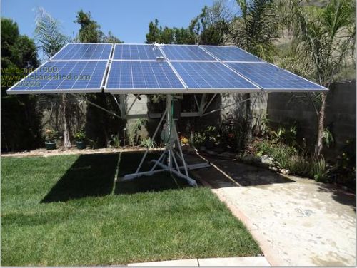

Hi guys
Well Alot has changed sense my last post last post
I was using a timer to control my solar panels.
Now I have made up a sun tracker with a picaxe 20m2 chip , it can be used with glenn's piclog2 piclog2
It works the west to east and the up and down, at night it turns back home (east) and goes up ,just in case of high winds at night'
It also has a wind indicator so if winds get to high it will go where ever you want it to, I have it go up so it flat.
Its easy to build and programmable ,software
here is the code , you can use this as a tracker only or tracker and wind mill logger

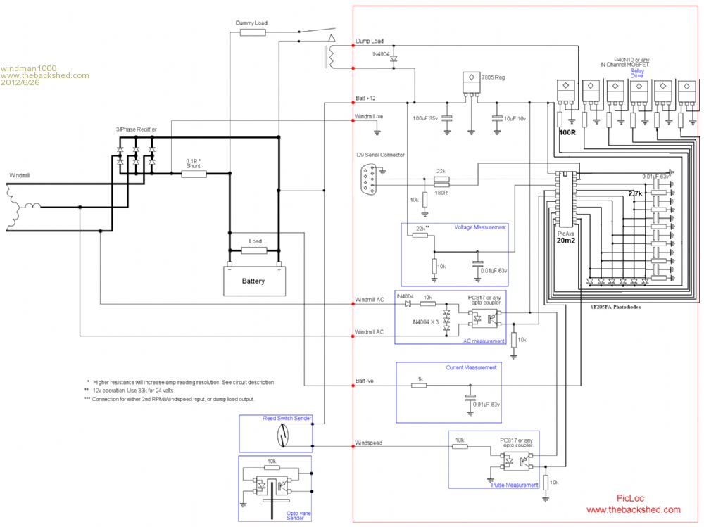

here is the circuit
And here is a modified piclog circuit

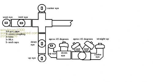

And a drawing on the eye setup
hope you guys like it

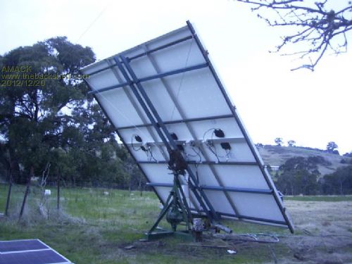

I'm about to fit the actuators soon, the panels are up and all is rock solid -the weather is crook at the moment,so I'm finishing off some hard wiring to the battery banks..

what actuators are you using( Voltage / ac or dc ) and do they have micro limit switches built in them?
And if I remember right you have 3 axis? you only need two.
you can build it your self very easy , and il help all I can.

I should mention that the photo diodes (eyes)are SF205FA photo diodes NOT LED's
I have not tested LED's as the eyes so I do not know if they would work as well, IF you try to use any thing different than SF205FA photo diodes the 2.7 resistor at the ADC might need to be changed to a different size resistor, The best way to test is at 12:00 noon in the summer time and no clouds , your com data number on the center eye or a eye that is pointed straight at the sun should not be more the 230, 255 it the max number and you will be out of range.
The reason I use the SF205FA photo diodes is to see threw the clouds ( it kinda works ) to where LED's Wont.

I'm with Pete regarding sun tracking methods, mainly because the electro mechanical solution is something I'm very familiar with.
The electronic 'Eye' seeking the bright spot in the sky method looks interesting and might have been fun to develop but the sun does not always cooperate and sometimes plays hide & seek behind fat clouds.
If I were to go down that pure electronic sun tracking way I'd use a program that calculates the sun's predicted position in the sky and drives an azimuth & declination activator to position the panels accordingly. This would place the panels in the correct position for every minute of daylight, whether there are clouds, complete overcast condition or clear blue sky. A feedback device on each axis would keep the computer informed where the panels are pointing to at any instant.
Surely' writing such a program can't be that hard. It even may exist already as the 'sun calculator' mentioned on this forum does exactly that - it predicts the sun's coordinates for any daylight hour at a particular location.
Klaus
windman1000
Joined: 21/06/2009
Posts: 91
Posted: 05:39am 31 Oct 2012
hi pete
the 12.7 volt dc is what i run the picaxe board threw a 7805 reg, in glenns piclog i adjust the dc voltage to 120v so i get the right wattage threw the CT to log watts on glenns piclog.
hi Tinker
one of the biggest reason i went from timing tracking to eye tracking was when it is hazy / cloudy the best sun is not directly at the sun threw the clouds the photo diodes i use ( not LED,s) find and track the best sun/wattage, don't get me wrong i did like my timing tracker but it was not as good as my photo diodes tracker for over all wattage in a day with clouds,and it tracks perfect up / down / east / west when the sky's are clear, there are times when there are heavy clouds out and the tracker points straight up flat but im getting the most wattage and i wouldn't with the timing tracker.
P.S.
pete im not in anyway a electrical tech , i think all i need is 0-15 amp scale with the CT is there a resistor i can change to try and make it more scaleble in that range? Edited by windman1000 2012-11-01
Warpspeed
Joined: 09/08/2007
Posts: 4406
Posted: 10:18am 31 Oct 2012
  Downwind said
I am one person who thinks photo sensors for solar trackers are a waste of time.
Quite simply the sun travels an arc, so precisely you can set your watch by it, to me it makes perfect sense to use time to rotate the panels by, this is far easier and more reliable that photo sensors.
Pete.
I really like this this approach as well.
Probably an even better way might be a combination of a clock driven tracker, time corrected with an optical sun position sensor.
I did at one time seriously think about doing this with a stepper motor driven from a crystal oscillator, with a variable modulus frequency divider.
I even collected all the parts to buld a prototype, but other projects keep getting in the way.
When there is full direct sunlight, the tracker very slowly self corrects by running either slightly fast or slightly slow. With less than full direct sunlight, it just runs off the theoretically correct divided down crystal frequency.
It could track forwards east to west for 16 hours during the day, then at night travel west to east at twice the normal rate for 8 hours back to the start position.
If the whole thing was built on an equatorial mount, it will track the sun, but require the elevation angle to be slowly corrected for the season. This could also be made fully automatic by checking the sun elevation at exact solar noon and appropriately adjusting the tracking axis elevation with a leadscrew.
The whole thing may take some time to properly self adjust, and lock onto the sun, but once it has, it should then predictively track even with many consecutive days of full cloud cover.
Cheers,  Tony.
Posted: 03:04pm 31 Oct 2012
From the testing i done you can expect around a 25% increase by just following the sun with the panels on a fixed angle.
By adjusting the angle as the panels track will give about 2-3% more, to me its not worth it for 3%. (perhaps a 1-2 time a year manual adjustment)
The more crap you build into a tracker the more likely a problem will occure, keep it simple and reliable i think.
Im not convinced a stepper motor is up for the task, unless its a toy panel, you need high gear ratios or lead screws so wind will not turn the panels.
Try manually moving a panel over 15 mins of time to track the sun, and the angle of change required is 2/5 of f&#$ all.
You can build in all sorts of crap and gain 1% more, is it worth it??, just point the panels towards the hot spot in the sky and be somewhere in the ball park will return the biggest increase for the least investment.
With the cost of panels now anything less that 5-10% is just not worth chasing in my book, and 1 extra panel is cheaper and simpler than all the work in a tracker for a small return, once you get over about 20% return then its worth doing.
But a poor design can cost more than it gains, 1 dodgie sensor and the panels facing the wrong way for a day or 2 will loose more than its gained in a week.
Pete.
