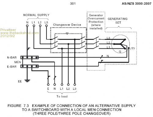

Tinker,
That sort of scenario is really getting into some of the other standards I don't use.
The below pic is the best answer I could give.
In regards to towers I have done a lot with microwave/wireless and the tower was always direct earthed to ground. Then depending on the area lightning arrestors may or may not be used on the electrical side.Edited by Privatteer 2012-09-03
Posted: 07:18am 02 Sep 2012
As per the diagram above that is correct to my understanding as well, it might be said that BOTH earth and neutral from the inverter should share ONE common connection each, and when you factor in using one or more RCD's within the wiring circuits then the neutral will need to be via a common supply.
Only the active should be switched (this might be different in the US where 2 phases are used (VAC 220) and no neutral)
I see no problem with a separate earth from the chassis of the inverter to its own earth stake as long as the chassis is not connected to the mains earth, this is actually requested in some inverter manuals.
With solar panels IF the inverter is transformer-less than the EACH panel must have a earth wire attached to it, a single earth to the panel mounting rail is not permitted unless the rail system is pre approved as a earthing system.
Panel earthing is not currently law in all Aussie states, but due to the fact it is in most then its a worthwhile practice to do.
I found when i installed my workshop roof full of panels the cordless phone simply would not work in the workshop any more, huge static noise on the line, once all panels were earthed the phone returned to normal in the workshop. (figure that one out)
