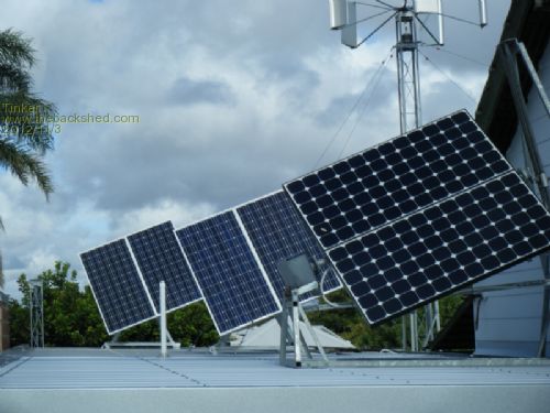

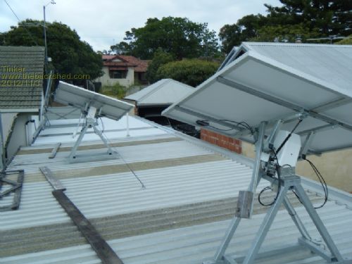

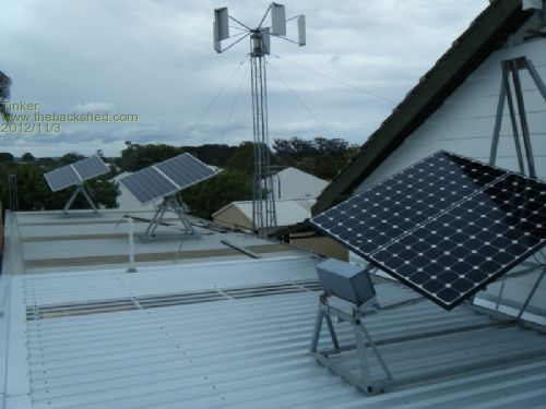

The only place for unobstructed all day solar at my small suburban block is on the flat shed roof so that is where the trackers are located. Due the wind loading anything bigger than a 2 panel tracker was asking too much of the roof structure. So I built 2 additional trackers . There is method with this decision, the considerable amount of mechanical work - I built everything from scratch - requires lots of setting up so doing more parts makes sense. Also, 3 trackers offer redundancy and deal better with shade problems which, fortunately, only happens in the low winter sun for one hour in the afternoon. The offending tree 2 houses away can't shade all 3 trackers at the same time.
So, here is my solar farm:
Another view:
And a closer up view:

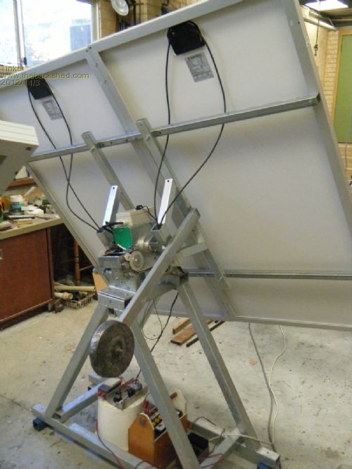

As mentioned, my trackers are all dual axis and are purely electro mechanical, timer activated. At each allotted time the timer switches 12VDC to the gear head for exactly one minute and the magic in there does its thing, advancing the panels 15 degrees E/W and resetting itself to be ready at the next time slot. No control power at all is connected to the trackers during the wait time.
The second axis activates once every 24 hours(Mk II trackers) and advances the sun altitude alignment by 0.25 degrees. That is a very small increment and took some tinkering to achieve. But, as my trackers are on the roof, I am saved the inconvenience to climb up there and adjust the altitude more often as single axis trackers require.
You can see the panels are counterbalanced (MK II trackers) with lead weights thus I got away with using quite small 12V DC drive motors. They are similar to the hi torque ones Jaycar sells but theirs run too fast (140RPM) so I got mine from e-bay (40RPM) and at less than half price as a bonus.
These motors drive a 120:1 worm gear via a spur gear reduction, the total gearing ratio is many thousand. The worm gears lock the assembly in position, I fitted a gas shock to prevent the wind rattling the panel frame on the shaft.
The two Mk II trackers were turned on last Thursday for the first time, tracking the sun. I was quite surprised today, being overcast & occasional showers to see a max of 47 Amps charge on the Wattsup monitor. This equates to 1.3Kw which is 120W more that the combined panel wattage of 1.18Kw. In total I got about 5Kwh charge today, can't wait to see what's it with full sun all day.Edited by Tinker 2012-11-04
