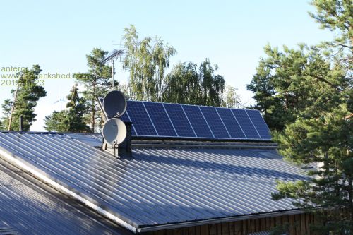

This is my solarpower unit.
I have two of these units, in other place, because of the shadow of
the chimney.
Together, 2750W and connected, to load my batteries,

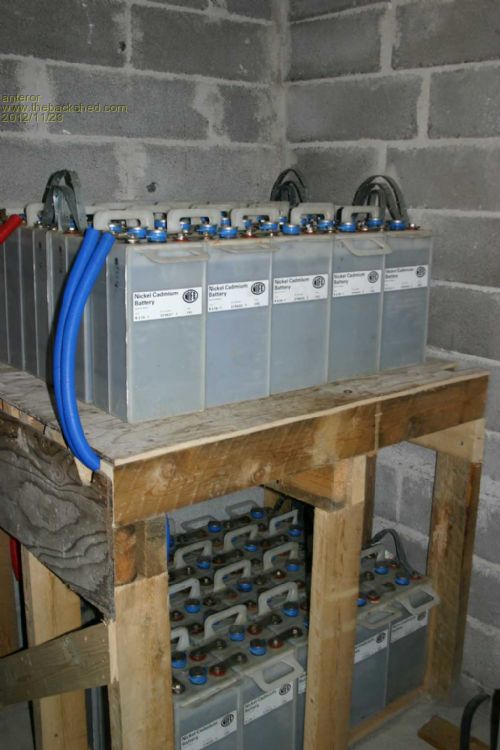

You can see half of my batteries here.
NICAD 2000Ah 24V.

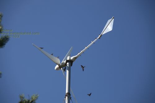

My windgenerator.
Connected without any charge controller to batteries,
with self made robust 3 phase rectifier.
There is a writing in this site about it;
http://www.thebackshed.com/forum/forum_posts.asp?TID=5285&PN =1

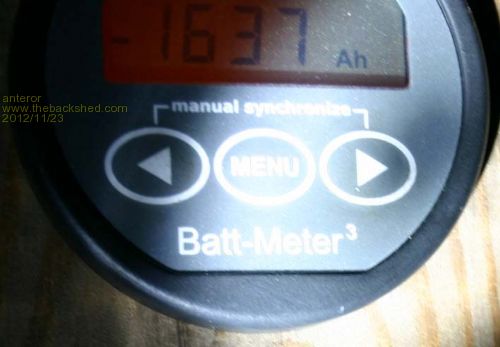

This is my energy meter, with 500Amp shunt.

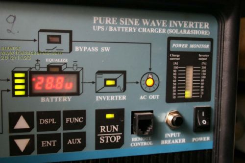

This is my inverter.
I have 2 units of these, 3000W pure sine vawe.
Have worked 24/7 without any faults for 7 years now.
From; https://www.fraron.de/wechselrichter/reiner-sinus/24v-auf-23 0v/swi3000r24vu-reiner-sinus-24vdc-230vac-3000-4200w/a-25626 12/
In the summertime, when the weather is fine..and the winds are
lowest, I get my energy with solar.
In the wintertime, there is very windy in Finland and
I get my energy from wind.
Hybrid is the only option in Finland
Solar power ends in october-november and the polar night
begins.

Sometimes when its very windy or sunny, batteries go to overvoltage.
My inverter shuts down automatically at 32V.
NICAD batteries do not mind at all from overvoltage, or from
undervoltage.
They charge these batteries with 500 or more..Amps in the ship,
where these batteries are from !
Actually they are fully loaded at 34-35V, in 24V system.
