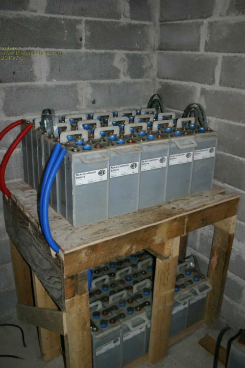

My systen with old ice braker NICAD batteries 2000Ah 24V;
My batteries, old ice braker ship batteries NICAD 2000Ah 24V.

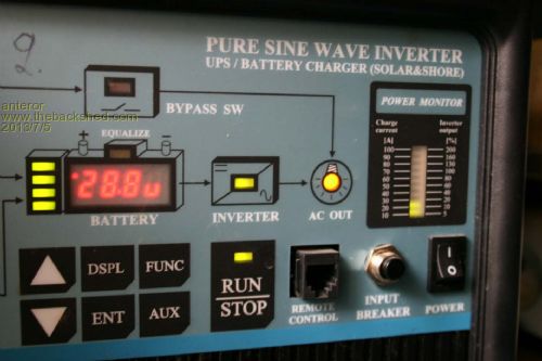

My inverter, I have 2 of these Fraron 3kw and they have worked for
a long.. time for me !

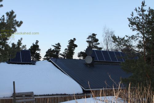

Question on the first picture ... what is the right hand roof covered in? Or have you removed the snow from it? Or is there no insulation in it?
