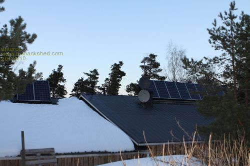

I have 11 units of 250W solar panels and have connected all in parallel,
in a 3 unit groups(one group is 2 units..) and these groups have 20Amp fuse.(factory recommendation).
I have tried and tested these with several MPPT and I get exactly the same power
without any controller

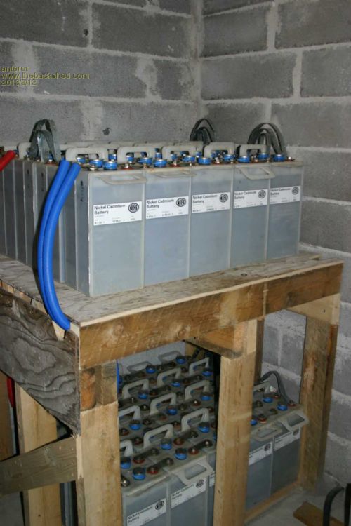

I have NICAD batteries, which are old used ice breaker ship batteries.
They have almost the same features, but not even near so good as NIFE
Edison batteries.
They have worked for over 30 years since manufacturing.
I have used them for 15 years now.
I have them 80 units 1,2V 500Ah, I have connected them in 4 X 20 unit
croups to make 24V 2000Ah.
They need to be run really empty once in the year.
That is all the maintenance they need.
You can charge them with any power and take..
BUT they will lose capacity year after year..and i can not rinse them
with water and the fluid is very poisones etc
SO.. good batteries is just, what we need, to be INDEPENDENT.
Solar and wind power is easy to have, to your own house in our time.
I will buy Edison NIFE batteries to my house after NICAD batteries.
That is what I want to leave after me to heritage to my children and to their children for decades to come.
Something truly sustainable..
Antero
Here you can see half of my batteries.
They say NIFE but they are NICAD batteries.
NIFE is the brand of manufacturer, which is nowadays SAFT batteries.
Made in Sweden.
