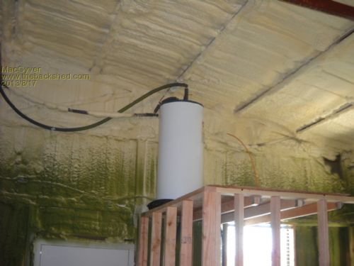

The receiver (water tank) is seen here mounted above my unfinished laundry room at the south end of my building.

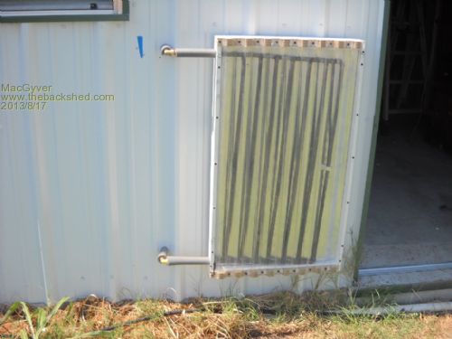

This is the collector panel (2' x 3') which is mounted permanently on my south-facing wall outside. The "glass" cover is bullet-proof Lexan and will withstand a direct hit from even the largest of hail balls.

I'm a little concerned about your tank sitting on that timber frame. Once full of water, it will be very, very heavy. How big a tank is it Mac? Any idea of it litres/gallons?

The (40 US gallons) tank and contents weigh in at about 400 pounds. I built the structure with that in mind. It is situated in a corner sitting atop a sheet of OSB and I intend to shear the walls below from the inside. As it stands, it supports its own weight and mine (250 lbs) without any problem. I intend strapping it to the wall in case it gets bumped or whatever. Earthshakes here are almost non-existant.
I "may" also build in a small closet below the receiver, which will transfer the load directly through framing members to the concrete slab, but it seems to be holding just fine for now.

Turns out, the tiny collector panel is not big enough to "pump" as vigorously as I desire, so I spliced in a small pump on a timer. Although thermo-siphoning works, the mechanical pump works much better, by moving more water through the thing.
Now, instead of a 'warm' shower, I get a hot one.
