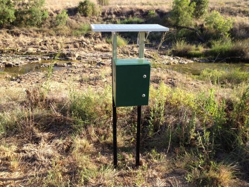

A few weeks ago, knowing the creek would stop flowing soon, I started on a new project, a solar pump. The requirement was the solar pump would supply as much water as the ram, about 500 litres per day, and it had to be a cheap build.
The pump is a little Flojet pump, 4 litres per minutes, over 30 psi, and draws about 1.8 amps. These are dirt cheap, you find them on ebay for around $30. For the solar panel I bought a 20 watt panel from Jaycar, along with a few components, including a PicAxe 08M chip. I had a 12v7Ah gell cell and box to mount it all in.

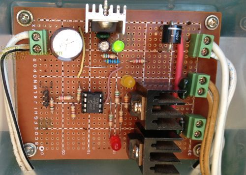

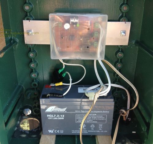

The PicAxe is configured to monitor battery voltage and solar panel voltage. If the battery voltage is good, it will cycle the pump, 10 seconds on, 20 seconds off. I cycle the pump because its rated for intermittent use, and the solar panel can supply 1.2 amps, the pump draws 1.8 amps, so I need to draw less than the solar panel can supply, to keep the battery charged. Also my water source is a living ecosystem, a soak fed pond with fish and other wildlife, so I don't want to take too much water away from it.

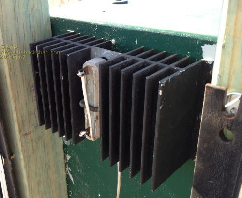

If the battery voltage goes much over 14 volts, the PicAxe switches in a 10ohm 40 watt dump load. Typically this happen in the middle of the day. I gone for a dump controller because its a simpler circuit that used components I had in my junk pile.
When the battery drops below 12.5volts, and the solar panel is no longer supplying current ( low sun ), the controller goes into night mode, and waits for the sun to come up and battery voltage to reach over 13 volts.

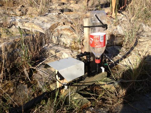

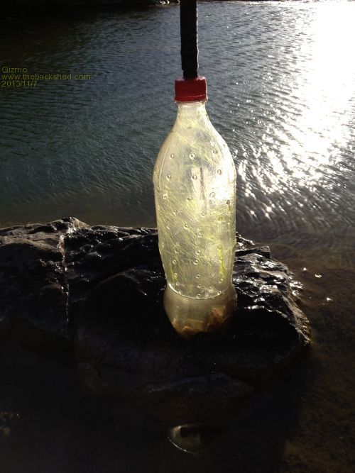

I'm using a coke bottle as a pressure vessel after the pump, makes it easier for the pump to start, there's a big column of water to get moving when it cuts in. In the creek is another coke bottle, with lots of little holes and a few rocks inside to keep is under water. It works well, and I have another inline filter just before the pump, its remained clean after a few days running.

The solar cell is connected to the battery via a diode. A MOSFET, driven by the PWM output of the PicAxe, switches in the dump load. At this time I'm just switching the dump load in and out to keep the battery under 14 odd volts, but I will play around with some PWM later, I was thinking of adding a little windmill to the system so it can run at night, and the PWM will be needed then, along with a lower resistance dump load.

darcyrandall200 not sure what coke bottle you mean. The one down stream would be the one next to the pump. Its a pressure vessel, or accumulator. By having a air cushion, it makes it easier for the pump to start and smooths out the flow a little. Without it, the pump would need to work much harder, especially in the first couple of seconds.
The other coke bottle sits at the bottom of the pond. Its basically acting as a pre-filter, to stop fish and other critters getting into the system. Its made with a coke bottle, a few rocks in side to make it sink, and about 50 little holes, about 3mm diameter, made with my soldering iron. It works well, there is also a fine gauze filter just before the pump and its remaining fairly clean, maybe a teaspoon of slime in it after 2 weeks.
