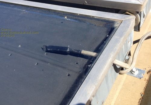

Yesterday as a experiment I fitted a couple of 22r 10w resistors into the panels. Connected in series, so each resistor was radiating about 1.5 watts, current draw works out at .27 amps. This morning the panels had a thin layer of ice, except for a hand sized area above each resistor, where it was bone dry, and the top 3/4 of each panel was also frost free, but wet with dew. Tonight I'll try the resistors in parallel, so each is radiating about 6.5 watts, current draw about 1.1 amps.
My 12v system can spare a amp or two, so its no loss.

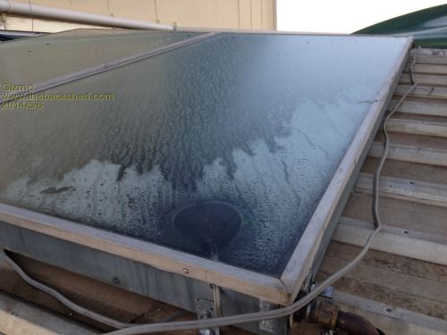

Posted: 07:56pm 05 May 2014
Photos of the resistor...
And the panel early this morning. You can see where the resistor sits under the glass.
Only the bottom corner had any frost on it, which makes sense.
