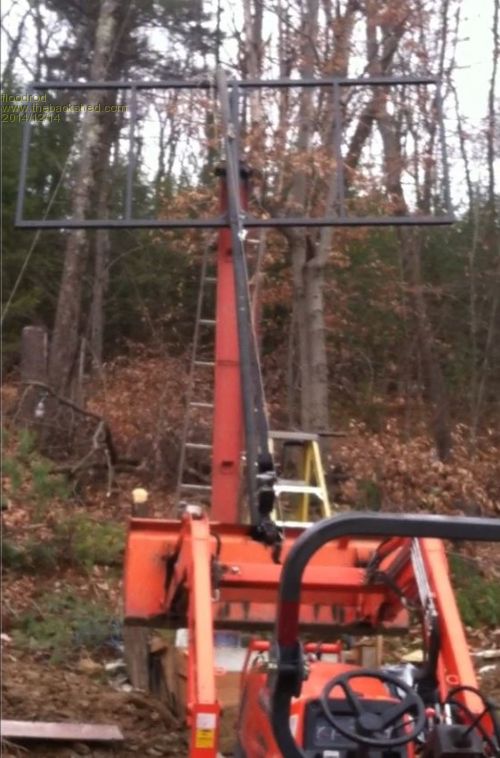

here is my home-made crane mounting the frame on the beam.. Now the beam has lateral supports

Floodrod what about bracing the tower. Pouring 3 or 4 concrete pads about 10 foot out form the base and use some 3 inch pipe to act as braces?

Posted: 11:59am 14 Dec 2014
Hi Glen,
I tried Guy Wires and it did like nothing. The I beam still twisted easily from torsion. Not sure if pipes would be any better.
I picked poorly. An I Beam is known to be poor with torsion and force opposite the web direction. I should have researched and just bought a round pipe. But now it's too late.
From reading about i beams, seems encasing in concrete may be the way to go
Posted: 12:24pm 14 Dec 2014
Pipes wont compress, where guy wires do. Using 3 pipes bolted to the top of the I beam and bolted to 3 concrete pads will basically create a 3 big A frames on each side of the tower, lots of triangles, very rigid. Actually when you think about it there are many more than just 3 triangles here. Use 3 or 4 inch pipe, and the thing would be hurricane proof, at least to the top of the I beam
Never been a fan of single post stand alone towers. All that force is concentrated at the base.
