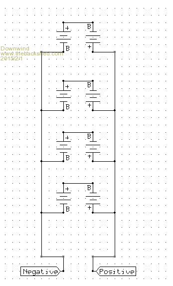

Hi there pete im goin to go 6 volt mate trojan t105 flooded 225ah can get them fof around $220 each .im thinking of getting 8 in totall, at the moment I have one 12v battery so how do i conect 8 batteries up to my pl60 contoller
Posted: 12:09am 01 Feb 2015
225AH for around $220 is the going price these days. You could probably get them a bit cheaper for a quantity of 8. My battery bank consists of 8 230AH batteries and I paid $1600 for them about 3 years ago. They weren't Trojan, but a reasonable quality golf cart deep cycle battery.
Are you running a 12v system? If so, you would connect 8 in a series parallel configuration. 2 batteries paired off in series will give you 12v, and 4 pairs are wired in parallel. If you dont know how to connect the positive and negative terminals to get a series parallel 12v battery bank using 8 6v batteries, then you shouldn't be dabbling with this sort of thing sorry. Wiring up and maintaining a battery bank requires a certain level of knowledge, if you get it wrong it will cost you money in damaged batteries and possible injury.
Posted: 12:10am 01 Feb 2015
Like this if using 8 X 6V cells.
Pete.

Posted: 08:33am 01 Feb 2015
Three other considerations:
- if you need 12V at 880ah (4 * 220ah) then you should be considering going to 24 or even 48Volts
- you should consider NOT paralleling battery strings
- make sure you properly fuse this setup, you are talking about a lot of energy
To balance the discharge and charging currents in parallel strings properly gets complicated.

Posted: 02:23pm 01 Feb 2015
I've always been puzzled by the advice to not parallel battery strings. It doesn't make any sense to me. Can you elaborate Dave?

Posted: 04:43pm 01 Feb 2015
Because it is hard to get the batteries to charge and discharge equally unless you wiring is exact making the resistance exact to all points. You end up undercharging some batteries or over charging others.
http://www.smartgauge.co.uk/batt_con.html
Sorry I still didn't figure out the posting of a link. It was explained to me but now I have to go back and read it.

Posted: 10:55pm 01 Feb 2015
hmm.. yeah, okay. I'm pretty sure you'll get more variance between the batteries internal resistance than the difference in wiring would make, but I note all of those batteries are wired in parallel. Surely pay attention to decent wiring would be better advice than don't wire in parallel?

Posted: 01:21am 02 Feb 2015
Dave,
Your point taken, but is it a big issue with flooded cells i think not.
Gell cells may be? but flooded cells are more forgiving, so what, if you boil off a little water from some cells in overcharging to bring others up to equal charge, it just means closer battery maintenance required to top the levels up.
We dont all have the budget to live in a ideal world, so we make substitutes to best suit our budget.
As pointed out previous the quality of connecting cables are a great importance.
Pete
