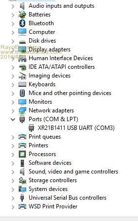

Ray of Sunshine
Joined: 04/04/2016
Posts: 1
Posted: 02:45am 05 Apr 2016
It's a rj45 to usb converter with electronics in it.
In windows it appears as XR21B1411 USB UART device in device manger.
you can get one from
http://www.bimblesolar.com/offgrid/mppt/TracerUSB
There is a usb driver included with the pc software from here.
http://www.epsolarpv.com/en/uploads/news/201508/1438913384728329.rar
I had to run the software in windows 8 compatibility mode as I am on windows 10 and make sure you check the RJ-485 mode on the device in device manager.
The software doesn't really tell you anything new but makes customising the settings a bit easier
