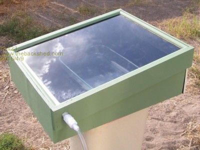

Hi Upwind,
Have you seen ideas like this?
Plenty of examples to Google & some performance tests on YouTube.
That one came from here.

Thanks Phil23, some good reading there. Am I right in thinking that to use the distilled water for batteries there should not be any metals in the system ? presumably the VOC's given off by pvc are not detrimental to batteries as I like the idea suggested that one could open up the pvc tube to become the collector AND drip tube in one? I certinaly need a still like that as my currant model fills with water every time it rains , witch living in a tropical rain forest is often. Thanks again Phil, Rgds, BD.

  upwind said   Thanks Phil23, some good reading there. Am I right in thinking that to use the distilled water for batteries there should not be any metals in the system ?
I'd think aluminium for the drip tray would probably be Ok as aluminium has a tight oxide skin.
Don't think any normally makes it into the distilled water.
