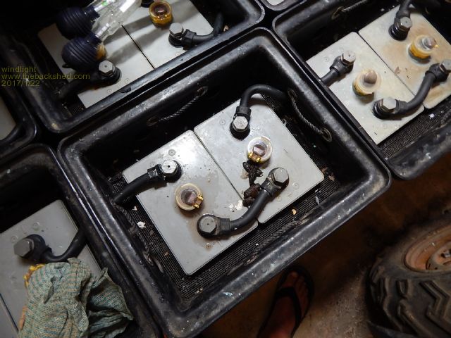

Well my 48v bank of Exide's have now been install since May 2011, so coming up to 6 years. In that time two have failed and been replace FOC with assistance from Nick from Solar Works. Having noticed some of that nasty green gunk around some of the terminals, today I set about removing each strap and cleaning etc.
Not bad for near on 6 years service but well overdue, so after a gallon of sweat that part was finished, all bright and shiny again, probably needs to be an annual event from now on.

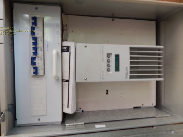

In turning off the 240v at the house MCB's I note another of the power MCB's does not trip on the test button. They are Hagar and I have already replaced two, once they were supposed to be a good brand. I shall list that job for Ron, later ron.
I have a total of 18 DC MCB's for the solar panels and found four not operating, they are a brand I am not familiar with, something like 7 leaping goats power company, so I doubled up on other breakers for now, yes still well within capacity.
When I went back to take a pic of the squeaky clean batteries I found this deposit...........

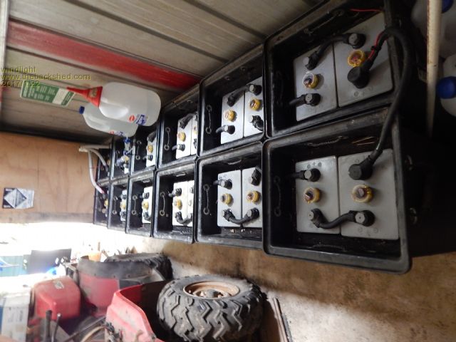

The cleaned again bank.

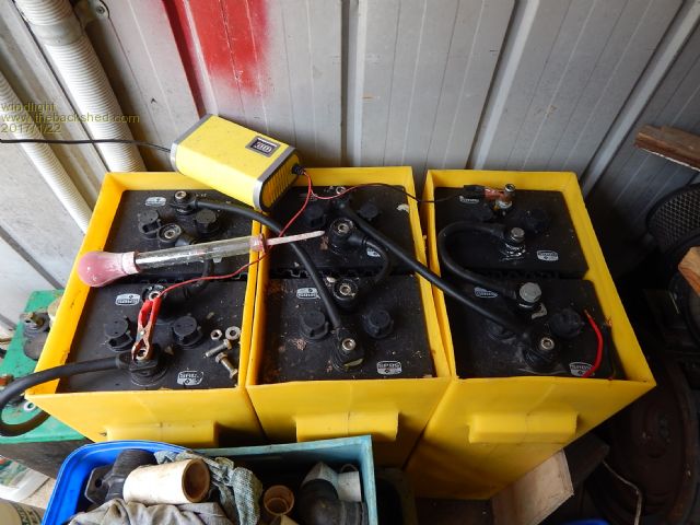

These are left overs from a mates bank, he replaced them when one failed, I was able to make up a good 12v bank for a friend. She now has a ceiling fan and a real fridge, ah the luxuries. To complement this we installed 10 second hand solar panels which seem to be holding their own.

The green gunk means the cells are no longer sealed around the posts and leaking gas around the posts, check the vents in each battery cell or leave the caps loose.
Also check your max voltage control system as it would imply you are gassing you cells greatly.
