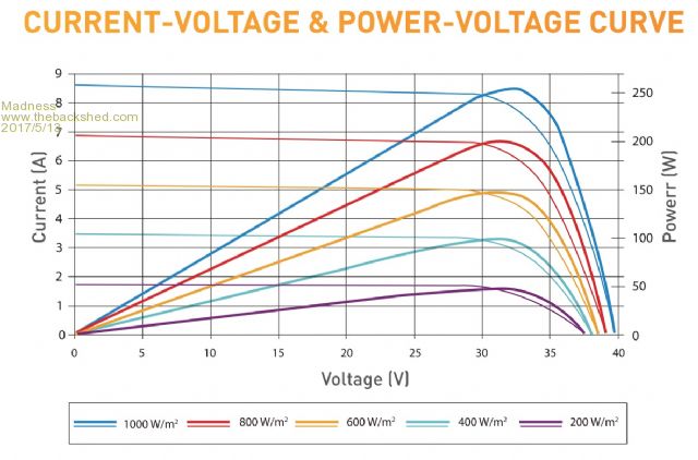

This graph for some panels I have says volts stay the same at different light levels.

I am thinking, if a panel power max is aligned to a reasonable battery charging voltage (and the battery is protected from over-voltage) the panel will automatically be operating close to the optimum point

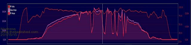

MPPT as the name says is tracking maximum power point, the graph below is from one of my Midnite Classic MPPT charge controllers. It operates at a lower voltage earlier in the day and late but during the day with clouds coming over there is little change in the volts.
Top red line is PV volts, other red line is PV amps, violet line is Amps out of the controller.

What is the load (controller out) voltage, I am guessing 24 v ?
[nice chart too..]Edited by chronic 2017-05-16

It is 48V, there is a lot more information available but I made it simple for clarity.

Doh ! I was looking (squinting) at wrong scale ! (30 etc on left but that is current not volts, now I see volts scale is on right ).
