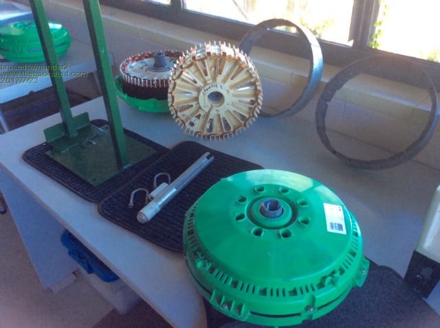

Have a couple of them from long time back .found them while cleaning up .massive bearings and large magnet ring. Can easily rewire.That's my homemade shaft ,the main cable exits out through the shaft ,while the green magnet enclosure spins.
BruceEdited by brucedownunder2 2017-07-24

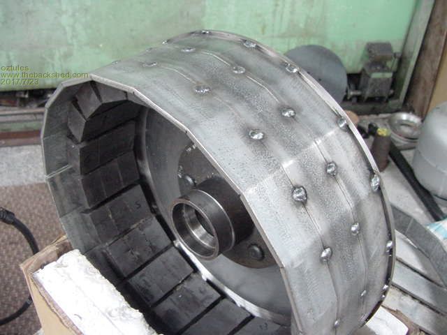

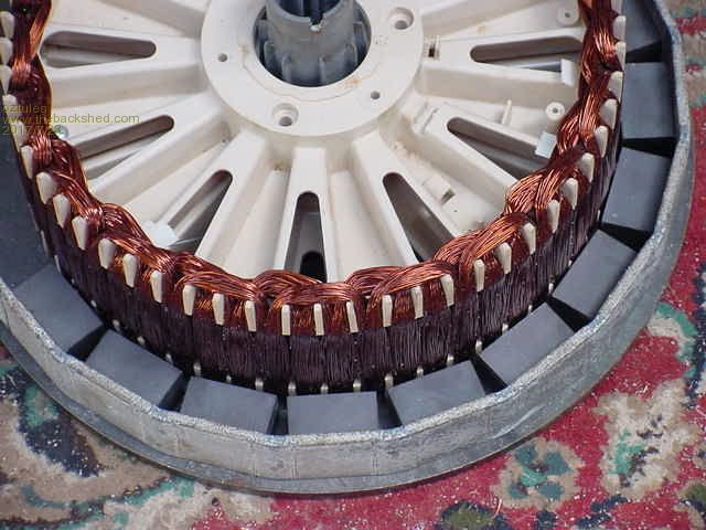

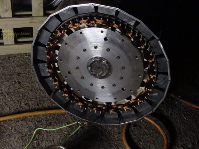

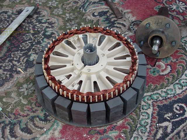

Yes I modded one... just a bit....
Does that count?
here are more pics of that project
http://gallery.anotherpower.com/main.php/v/Oztules-toys/album42/
........oztulesEdited by oztules 2017-07-24

Knowing what I know now, I would have it up on a pole... but I gave it to Dennis back in the day.... I think he found love and dropped windmills, so no idea of where it is at present.
It would have been perfectly fine.... but I was comparing it with my axial flux which I could pull 5kw out of... so the 1kw or so from that was not worth considering.
Like I said, knowing what I know now, I would have shown a lot more respect for it.. it would have been ideal, and a close approximation of the AWP... which has been a real winner down on this island for about 10 years in the marine wind.
I have not touched a PJ /w7 board for a long time, and they are still running around the island.
I trust yours is still fine too.
I actually liked the way I used the strip steel. ( from power pole cross arms ) to make the drum. She was solid... wish I still had it.
