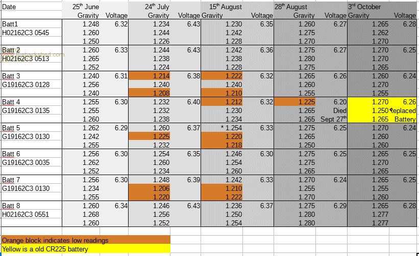

Posted: 09:58pm 23 Jul 2017
Nice find Yahoo, I looked everywhere for that data.
Figures today are sad. This is at the end of a sunny day, normal charging cycle.
There are 3 columns below, the first was taken at 7am a month ago. The 2nd was 5pm that afternoon. The 3rd was taken today. It appears they are getting worse.
Thoughts?

Posted: 05:18am 24 Jul 2017
in my opinion there is 14 cells that have acid concentrations that are 15% to 21% lower than where they should be. There is only five cells that are even close to reasonable specific gravity.
the h2so4 concentration should be close to 36.5% SG 1.2775
I can see a couple that are at 28%
I have never seen that much variation in new cells. They have either plated the sulphate out due to some sort of contamination or the cells were partially filled with acid and topped up with water.
I would not be persevering with them.

So I contacted the manufacturer, Crown, in the USA. I told them I was advised by the local supplier to charge at 20 amps for 20 hours, was this OK? They replied within a day, and the reply basically said 20 amps for 20 hours would be a bad idea, and then went into charging routines, etc, etc, it was very comprehensive. I replied to them with more of the bank history, serial numbers and my log files, below.
Crown got back to me and said they were going to replace the whole battery bank They even offered to deliver them, but I decided it would be better if I pick them up so I could test them before loading them into my car.

Now I have a quick question. The supplier has advised they have the new bank charged ( hopefully not at 20 amps for 20 hours ), and ready to be picked up. I wanted to check the voltages and gravity's before I load them into my car, its a 300km round trip and I dont want to get home and find one battery is way off spec. What would be a acceptable range of gravity's for a new bank of batteries?

I think that they should be at least 1.2775 but that is anecdotal, you need someone with a set of crowns to confirm that they read 1.28+ when new.
I would be checking their acid premix SG if the numbers are low
