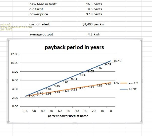

I was having a poke around at the new Energy made easy website and noticed that one major retailer had followed the lead of Enova and lifted their feed in tariff base rate to 16.3 cents.
Had a phone call this morning from someone asking if they should think about fitting more panels so I have made some assumptions and plucked some very rough numbers out of the air. We have to factor in what happens with renewable energy credits for upgrades and compliance with Australian standards changes since the original system was installed etc etc.
I would say if there is electricity that can be time shifted to the 10am to 4 pm zone that is normally imported then a reasonable amount of that sweet moola can remain in our hot little hand.
I wouldn't over-panel only to chase the $250/year/kw installed FIT if my power needs were already catered for, it equates to a maximum of 2.1 cents per Kwh reduction in the power bill.
PS the average output is low for my area because of the orientation of the remaining roof space available and some difficulty in matching panels.
