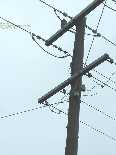

The lightning struck the power pole and blew the fuse holder off the power line, also blew 1 phase out of the transformer down the road.
(some time ago for safety reasons We had Energex pull the fuses from the power line across the road).
Poll is a bit splintered

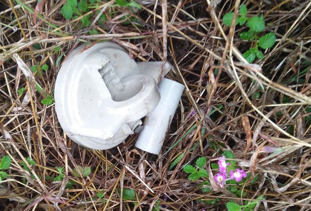

Busted fuse holder

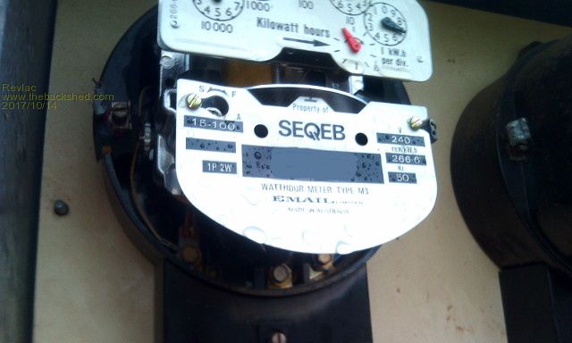

So much power it Blew the sh*t out of the power meter

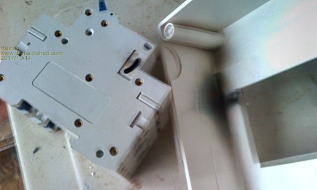

63A circuit breaker with flash over
Tripped all RCB and some of the MCB's

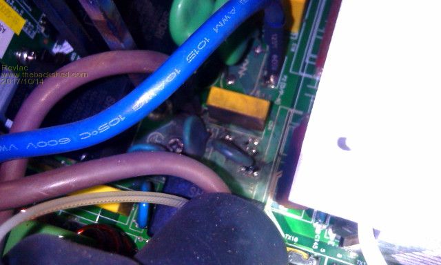

Then ultimately Blew the CRAP out of the OGI PIP Inverter,

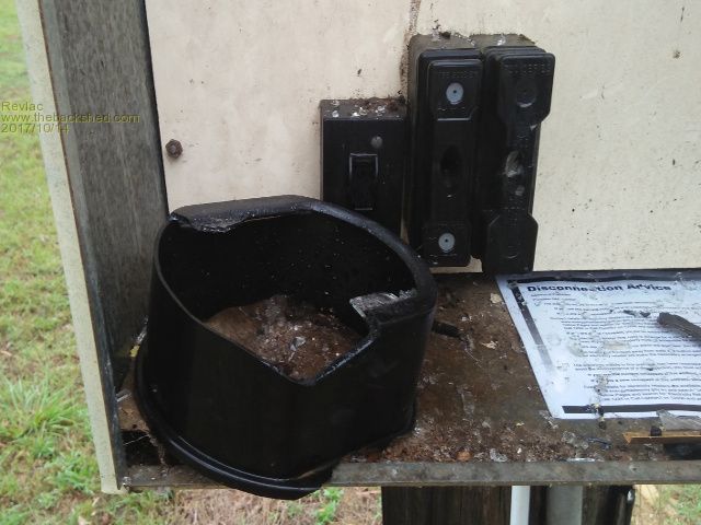

NOTICE. All fuse's on the power pole the meter box were removed
, The main switch in the meter box was off as was the main switch at the house and the grid and genny change over switch.
The MOV's took some of the strike
