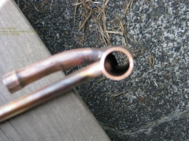

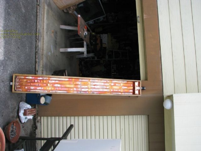

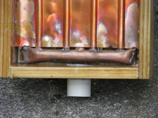

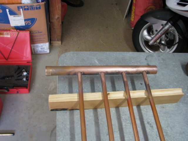

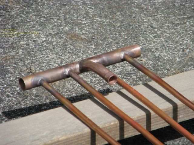

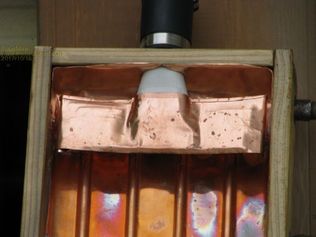

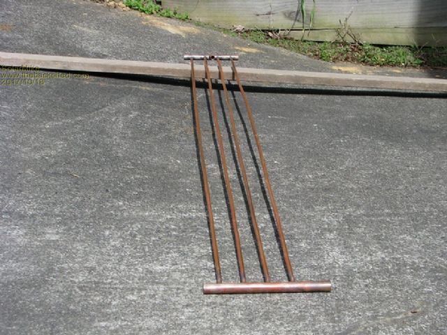

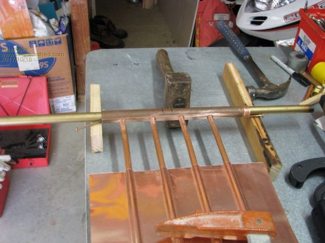

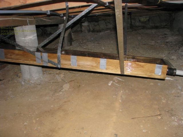

I built a heat exchanger device some years ago from copper tube and foil, placed it in a well fibreglassed timber case and placed it in the outlet of the most used shower in the house. Warm grey water from the shower outlet passes over the large surface area of the copper foil on its way to the drain, the cold incoming water supply to the shower mixer valve passes through the copper tubing and extracts some of the energy from the waste water, thus pre-heating the cold supply, this in turn means the hot tap doesn't have to be wound up as much and so saves hot water.
Normally we would get 4 showers from a fully heated HWC, now we easily get 5, so its a good saving; as 90% of our hot water is heated by solar panels on the roof, its especially effective in winter when there is less sun to heat the water up.
The heat exchanger preheats the water by about 8-10 degrees C.
Here are some photos
The copper tubes are welded, the thin 0.25mm foil is soldered to the tubes, bit like making a solar hot water heating panel, same as how I built the ones on the roof.
Mike
