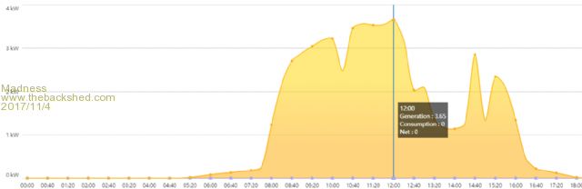

Congratulations George, that has to be the longest post I have seen on a forum .
If you look at the PDF on the first post in this thread and the NOCT of those panels you will see the expected output is 185W for a 250W panel.
I know someone who set up micro sprinklers to cool panels which did gain an increase in output but the power to run the pump canceled most of the gains.
I am with you just add more panels, as for angles the ideal angle for grid tie is supposed to be 10 degrees less than your latitude. Where I am here in QLD it is 26.5 so the optimum fixed angle is 16.5, this is supposed give the best total annual output. But as I am off grid maximum annual output means diddly squat. I need to aim for the most output on the worst days which is when there are thick dark clouds. What myself and others here have discovered is that for this situation is to have the panels laying flat. This gives the most power when there is full cloud cover diffusing the sunlight. Flat panels see more of the sky and therefore produce maximum possible output.
As for your comment about running 10KW of panels on a 2KW inverter, have you actually done this? I have been told most inverters will cope with 10 - 15% oversized array but 500% is probably pushing it way too far.
Here is my result from yesterday which only had a couple small clouds, the array is 5KW laying flat, it peaked at 3.85KW. After that, the output was reduced due to a regulation system I am using to control battery charge.
