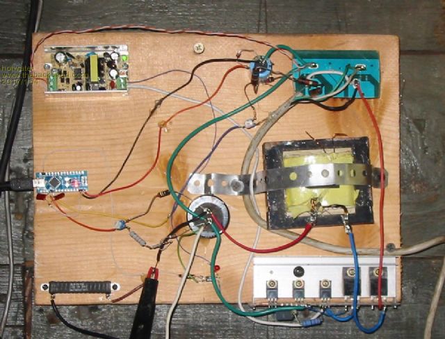

I needed a quick conversion from 60-70V down to charge a 12V battery. In 15 minutes I had this. Going clockwise from upper left.
This is a 110-250VAC 12V 1.2A supply I buy for $1, "industrial wall wart". Almost any wall wart will work at 50VDC at reduced current. I don't actually need this. It only supplies high side drive for the FET.
A pair of capacitors from a TV. these store the energy between pulsed and make it efficient. Get yourself an angle grinder with a thin cut off wheel. Make little assemblies from old electronics. A dropping resistor, capacitor and 8V zener supply raw power for NANO.
Transformer from an old UPS used as an inductor. Not ideal but free.
A FET and diode for the buck operation. Cut right out of a TV.
An opto isolator cut out to supply FET drive
A nano controller. $3 shipped. Add a USB cable and free download compiler and the world is yours.
Think you can make one as pretty? I run a whole house on one of these. Two water heaters. two bucks like above, one PWM for for the old odd lot legacy 12V panels and a refrigerator.
Spend a lot of money on professional hardware and you will never get it back.
Edited by hotwater 2017-11-05
oztules
Joined: 26/07/2007
Posts: 1686
Posted: 08:08pm 03 Nov 2017
Hotwater......Be proud to call it mine..... very nicely done.... now I want one too.

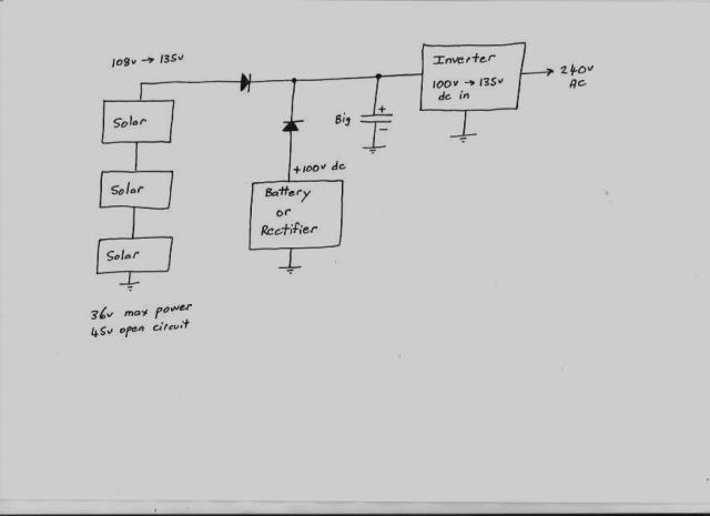

You don't say if your panels are 12v or 24v type.
But lets assume they are 24v (which are more common).
These will have a rating plate that will say something like:
Maximum open circuit voltage 38v
Maximum power voltage 30
Maximum power 230 watts
Short circuit current 7.8 amps
So what you do is hook those up to an inverter that will safely work up to at least 38v which is theoretically the highest possible panel voltage.
Now we do not want to overload those panels by pulling the voltage below 30 (in this example). That is the max peak power point, or very close to it for all operating conditions from total cloud cover to clear blue sky.
We can do that by providing a mains powered dc rectifier that supplies a continuous 30v dc.
At night, or on truly dismal days, the mains rectifier powers the inverter directly through a diode.
ANY solar contribution above 30v will drive the inverter and reduce the loading on the rectifier.
On sunny days the panels should be enough to raise the voltage well above 30v and no grid power will be consumed. In marginal conditions the solar panels will work as hard as they are capable of, and any extra load comes from the grid. The grid only supplies any excess load during poor solar days. Even if its 95% grid and 5% solar, the solar panels are still contributing all they are able to produce.
There will be a seamless transfer of power at dawn and dusk as the load gradually shifts from solar onto the grid, and back, without any abrupt switching.
No battery is required.
I have had a system like this running for almost two years without any problems.
A battery will eventually be fitted, but a battery is not really cost effective where grid power is available.
Cheers,  Tony.
oztules
Joined: 26/07/2007
Posts: 1686
Posted: 08:41pm 03 Nov 2017
Fiendishly simple Warp
.........oztules
Warpspeed
Joined: 09/08/2007
Posts: 4406
Posted: 09:07pm 03 Nov 2017
A system like that will produce about 50% of power through mid winter, and about 80% of mid summer power. That assumes there are enough solar panels to produce sufficient power during daylight hours except on exceptionally bad days.
You won't be able to do much better than that, because in winter its like 17 hours of darkness and 7 hours of solar.
In mid summer its still dark for 7 hours no matter how many solar panels you have.
It still makes a pretty big impact on power bills !
Cheers,  Tony.

If you still have the old rotating disc electricity meter and a grid tie inverter you cannot do any better than that.
But the good old days are rapidly coming to an end.
A smart meter means you have to abide by the rules, receive a pittance for any power fed back, and are about to get royally reamed.
My system is very simple, it feeds nothing back, and it runs if the grid goes down. At least while the sun is shining. There is also no need to synchronize the inverter to the grid, so the inverter only need be very basic.
The first thing to do is decide on a system voltage, the higher the better. I used 30v to 38v as an example only of what could be done.
My own system uses sets of eight 24v panels in series, generating around 220v to 290v dc operating range.
As everything has to be built, its a case of using what you have, or can easily get and deciding on a system voltage.
I am using a homemade inverter that is very different to the usual PWM type, but that is not really relevant to this thread.
Something could be home made by gutting a commercial grid tie inverter and replacing all the grid tie electronics with something much simpler.
For instance, the 1.5Kw Inspire inverters work over a similar voltage range, 200v to 400v dc. So the original output toroidal transformer, choke, and PWM filtering would work fine with a home brew circuit based on one of those EGS002 PWM generator boards.
Those inspire 1.5Kw toroids have a 135 volt primary and a 230 volt secondary.
The primary 135v has a peak voltage of 190v so it will work from anything over 200v incoming dc.
We are both very fortunate in having three phase power available. My rectifier uses three more of those Inspire transformers, 230v primary to 135v secondary. Rectified that gives about 190 to 200v dc as the mains here is usually a bit higher than 230v.
Most people only have single phase available, so the simplest solution might be to try and buy an old fork lift battery charger at an auction or e-bay, and build a system around that. Another possibility would be to wind your own transformer for whatever voltage is needed.
If there are no plans for a battery, then the higher the dc voltage the more efficient it will be. That is especially true of the capacitor bank that will be required for both filtering the rectifier output, and as a low ripple voltage source for the inverter.
The inverter input current pulses heavily, and solar panels are a high impedance current source. So a large smoothing capacitance will be required. A grid tie inverter will already have that, but a few extra microfarads will not go astray.
If doing all this at a much lower dc voltage, the smoothing capacitance needs to be made much larger.
Its not really possible to give exact instructions how to go about this, as so much will depend on the power level and what parts may be available. But if you can base it around an existing grid tie inverter (working or not) you would be off to a pretty good start.
Cheers,  Tony.

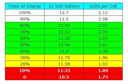

MPPT yes and no, yes it can be done but the cheapies will not reliably drop that much voltage, it will either be outside of their max voltage parameters and not work at all or it will blow up. Even some/ most of the PWM controllers will complain about high voltage and not work.
Battery voltage
because batteries are a chemical reaction that resist work (lazy like me )you have to think about voltages differently when the battery is charging, resting and discharging.
Batteries are always quoted at rest, that means not having been charged or discharged for 2-4 hours. so the spec sheet is going to say 12.5v or 12.6 volt or maybe 12.7 volt AT REST
Here are some state of charge numbers AT REST
if you are discharging the battery the load will lower the voltage further because the chemical reaction cannot keep up and it will recover as soon as the load is removed.
same goes for charging, the harder you push the energy in, the more the battery resists and the higher the voltage rises. so you can trickle the current in over a week at 13.8 volts and the battery will fully charge. To charge it from 60% to full in a few hours you are going to have to be 14.3-14.8 volts to overcome the chemical resistance.
As Oztules says once they are very close to fully charged if you dont back things back to an idle you will lose water out the vents. As he also says with glass mat, sealed lead acid and gel batteries things need to be far more precise because once they fill up there is nowhere for the energy to go, lithium even more so, although lithiums have the advantage that they dont suffer degradation if they are not fully charged so we can leave them at 90% for years at a time.

[quote]do you have any reading material on how a old GTI can be repurposed and how is the output V controlled when its not GT
I currently have 4 of these but happy to hunt up another set [/quote]
The parts you can use from an old GTI would be the metal enclosure, heat sink, toroidal transformer, choke, and output filter.
But these are all major high value parts, and already assembled and ready to go.
What you don't need is the original circuit board, so a blown up or faulty GTI would be ideal for this.
The primary winding on the toroid will determine the minimum dc input voltage that will be required from the solar panels, and the original GTI specifications will tell you that.
Its then a case of building something like an "Oz inverter" to power the primary of the toroid. That will include the required ac output voltage regulation.
Because this will be a high dc voltage inverter, only four mosfets or IGBTs will be required, not a dozen or more as is more usual for a low dc voltage inverter.
All you need to drive that will be one of those low cost Chinese PWM driver boards.
I am about to do something like this myself when all the other unfinished projects I have going at the moment are completed.
Cheers,  Tony.

  Warpspeed said   You don't say if your panels are 12v or 24v type.
I thought the simplicity of this idea was brilliant!
So I stole it! :0)
I have an old fridge I am using for raising seeds. It has an LED bar light in it which provides Light and warmth at Night. It's rated at 12-24V but handles 30 no probs. I have been powering that with an old car battery charger as a power supply.
I also have a shattered solar panel which I don't want to put in a string but still seems to be providing full voltage and amps. Taking your idea, I put that up on The shed roof behind where the fridge is and just connected it directly to the junction of the charger and light.
Works a treat.
I was going to put in diodes but remembered both the panel and the charger have them built in and testing proved one does not try to drive the other when they are the dominant power source.
Very happy with this. It's not a lot of power draw from the light but I had the panel doing nothing anyway and it's a great way to put it to use.
Great idea and thanks for passing it on!
thanks again for your input and ideas
thinking about this today and remembered that AC rectified is 1.44 times higher at DC.
so rectified mains will come out at a tad under 350DC and solar input would need to be apx 400v dc
Not sure I want to play with that at those currents.
The idea of useing a transformer has me concerned about losses as transformers are typically only 60% efficient (from distant memories)so running this way 24 hours will cause some serious losses and all but waste the solar power generated.
damned if I do and dammed if I dont.
a thought occurred that the transformer set up could be bypassed by suitable timer relay/contractor between mains and inverter output provided the the inverter didn't object to having mains back fed to it, is this a realistic fix.
starting to think that buying a 3kw solar system and having it installed is a better way to go.
them I still want to play just not with 350 - 400v dc

No load losses in a 1.5Kw toroidal transformer might be about 12 to 15 Watts, nothing much to worry about. Flat out efficiency is less important because it will very rarely run at full flat out power for any length of time, but I would make a rough guess at about 85% efficiency flat out, and better than that at lower power outputs.
Many grid tie inverters work in the 200v to 400v dc input range.
The transformer primary might be typically about 135 volts rms, requiring a minimum dc input of at least 135v x 1.414 = 190v.
Cheers,  Tony.
