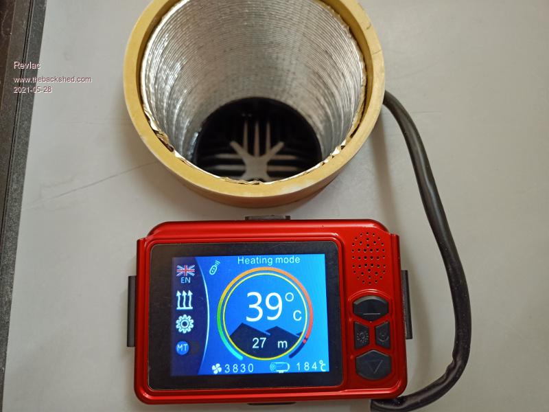

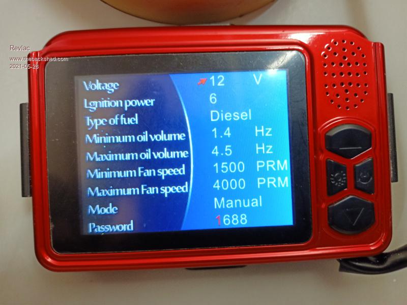

Have a photo of the screen and settings, looks like The control unit has a temp sensor in it, and is too close to the heat outlet.

  Quote  Have a photo of the screen and settings, looks like The control unit has a temp sensor in it, and is too close to the heat outlet.
Mine has the temp readout in it too but pretty optimistic. Sometimes it's out by 5o.
Must want you to think it's doing a better job than it is.  I have just been running mine in manual Mode. Never going to get the temp up much where I have mine, happy for it just not to let the place get too cold.
