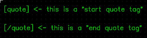

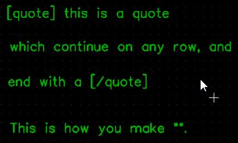

vasi
Joined: 23/03/2007
Location: Romania
Posts: 1697
Posted: 10:28pm 10 Jun 2010
And you use them like this:
And, if you want a name like: "Glenn said:", then the "start quote tag" must look like this:
[quote=Glenn]Actually, Vasi said: "this is a quote which continue on any (should said "on as many rows you want") row, and end with a " [/quote]Edited by vasi 2010-06-12
