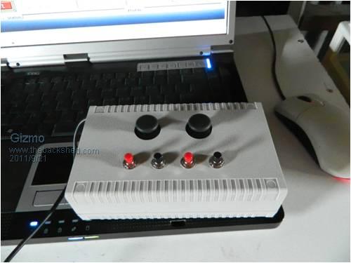

I wanted to make a pendant controller for my CNC router. Having used commercial laser cutters and CNC routers, you learn to appreciate a pendant. It lets you get up close and personal to the job at hand, and move the tip/tool around the surface without looking at the controlling PC.

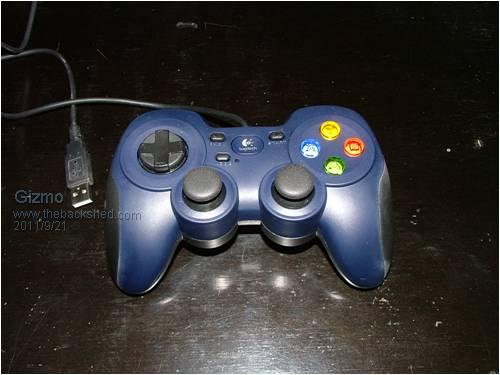

I bought a Logitech game controller for the job. Its got two analogue joysticks, and numerous other buttons I can tap into as I need them.

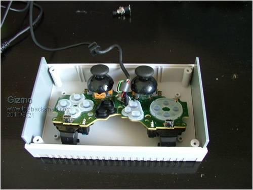

I wanted a customisable case, so I pulled the controller apart and found a new box to fit it all in.

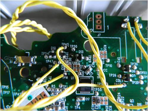

I cut holes for the joystick knobs, and mounted 4 push button swiches. Later I'll add more buttons as I need them. Then I mounted the circuit board in the box and wired up the switches to the test points on the circuit board that ran to the controllers switch pads.
All back together. I'll add labels in the future.
The Mach3 softwares comes with a key mapper application. The key mapper is used to map keyboard/joystick events to the Mach3 functions. I've set up one joystock to move the X and Y axis, the other to move the Z axis up and down. The 4 buttons are Start, Stop, Pause and Rewind. Once a program is loaded, the pendant can be used to position the tool on the job, and start the program once the axises are zero'd.
