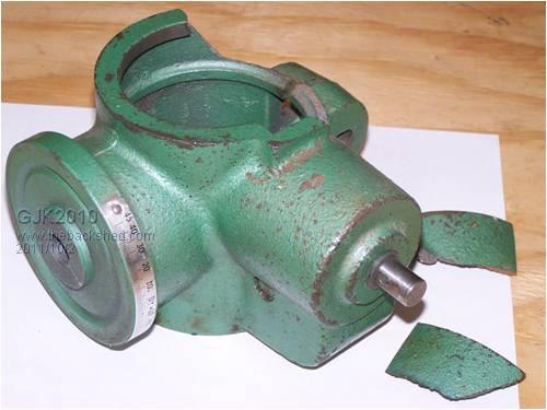

Does anyone here have a floor model drill press? Is what I have is a Sanchin drill press and the table evelator bracket that rides on the main column, that bracket broke and I would like to know if anyone could help me by measuring the colunm's so maybe I can find one that may work for my press. The colunm needs to be 2.441".

You could get that one brazed back together and re machine the column hole as it doesn't seem to badly broken.

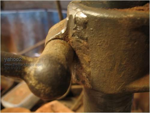

It looks from the pic that the ring inside where its parted doesn't touch the post that gives more area to build up weld.

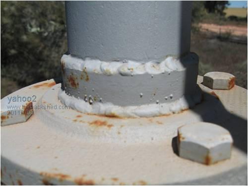

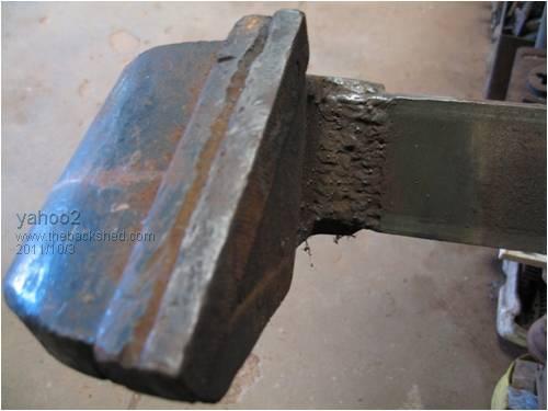

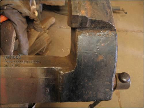

Heres a couple of photos of stuff that has stood the test of time and broken most of the rules
this was arc cast weld with steel plates welded to the sides I was a school so 30+ years ago
This is zinc coated steel to sh#t cast done with a mig welder and standard steel wire (not recommended) it holds a 4 metre satellite dish.there are cracks but it will handle about 5 tonne side load, the test one did anyway.
