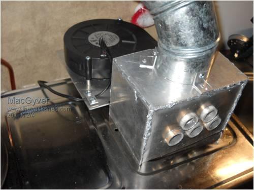

The body is solid aluminum plate. I "welded" the seams where the
1" ID aluminum tubes penetrate the walls. The idea here is it sits atop
a burner on my stove and as much heat as I'd use to make a pot of coffee
heats the tubes inside. I then force air through the tubes into the room.
The exhaust fumes and burning air is sucked to the outside with my
range hood fan.

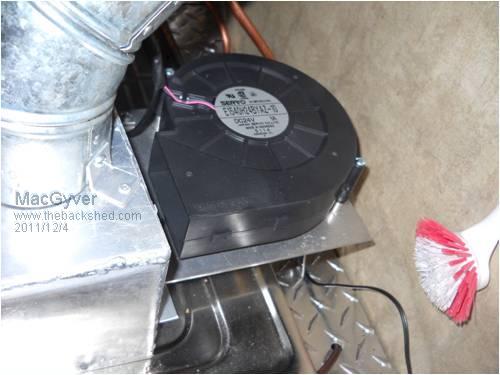

This shows the 12-volt squirel cage fan that drives the air fom the room
through the heated interior of the aluminum tubes.
Here's a side shot of that same fan. I used stand-offs to hold the plastic
fan body off the metal surface as well as placed the fan about an inch
from the really-hot tubes. I did this so as not to have any "melt-downs".

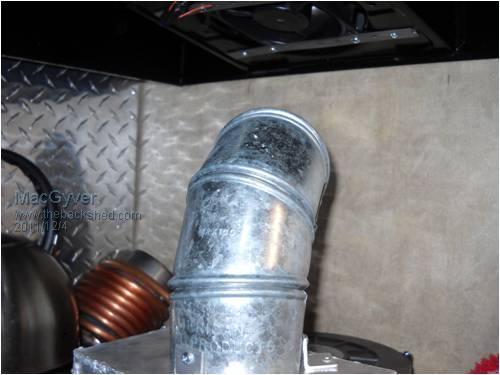

This picture shows the gravity vent atop the unit. Its outlet is aimed at
the range hood's 12-volt fan that takes cooking fumes through the wall
to the atosphere outside.

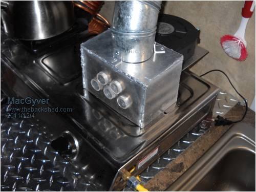

This is a front view of the fire box. The 5 tubes face into the room and
cool room air is forced through them from the fan in the back. This is
what heats my galley and state room. My place is vey small, so this is
actually enough to do the job nicely. My whole living space is less than
200 square feet.

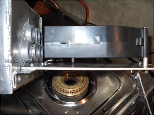

Here's another view showing the fire box, through-tubes and driver fan
at the rear. There is also a post on a hinge used to support the rear side
of the whole thing on the counter top.

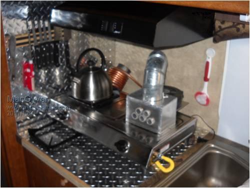

This is my entire galley. That's a two-compartment sink to the right side.
That copper coil in the background is used to top off the water temperature
on days when I have little to no sunshine. It works well, but is unsightly and
I am going to replace it with a welded cylinder closed top and bottom with
an inlet and outlet fitting for the water to pass through. Either merely sits
atop a stove burner and I use propane to augment my electric / solar water
heater's efforts.

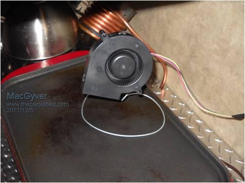

That little toy FAU took me all of nearly 3 days to cut and piece together, but after reading your reply, I concocted this little number in about 5 minutes:
This little 12-volt fan is supported by a wire frame I bent together in
about 4 seconds and the whole rig sits atop my cast iron pancake
griddle. It doesn't deliver as much concentrated heat, but it gets the
job done at about 1/100th the effort.
The wire holds things away from the hot surface enough to keep the plastic fan case from melting while holding the fan in such a position that it gathers cool room air and splashes it against the hot griddle, then sends it out into the room.
Fortunately, I enjoyed all the planning and tinkering of building my more-complicated first try, but for sheer simplicity, you can't beat Bob's idea.
Bob, you're a genius!
