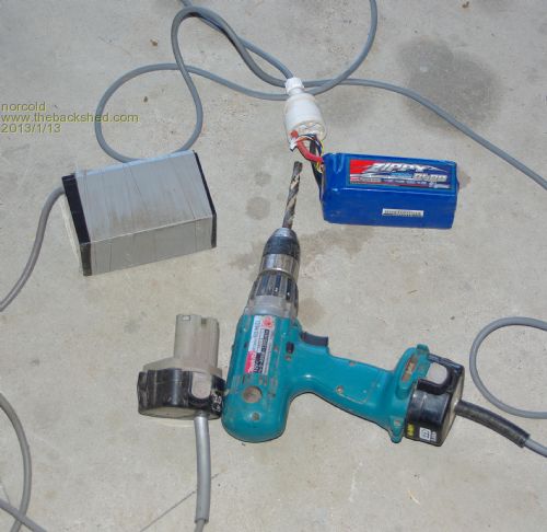

Yeah, if you wish to get away from nicd`s. Here`s a couple of alternatives. One on left is a 12v gel cell(easy to charge) one on right is LiPo4.(needs a special balancer-charger) Can vouch for the gel cell,gave many years of service. LiPo4 is only new and should be the bees knees.
Place battery in pouch on belt around waist. Pull battery apart and solder wire to terminals.
Cane toads in the freezer do not attract the blokes in white anything like batteries.

norcold
Joined: 06/02/2011
Posts: 670
Posted: 09:20pm 13 Jan 2013
That plug in photo is a Clipsal 32v polarised 2 pin plug. Would never use or advise people to use 240v plugs on low voltage. A big NO NO from a safety perspective. Even the cable is not 3 core but 2 core 2.5mmsq.
The Anderson plugs as MOBI advises are more readily available nowdays, I`d go for them.
Vic
